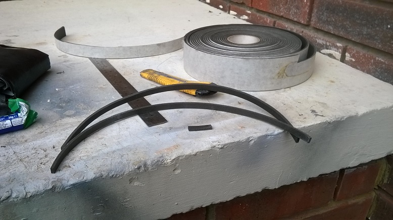

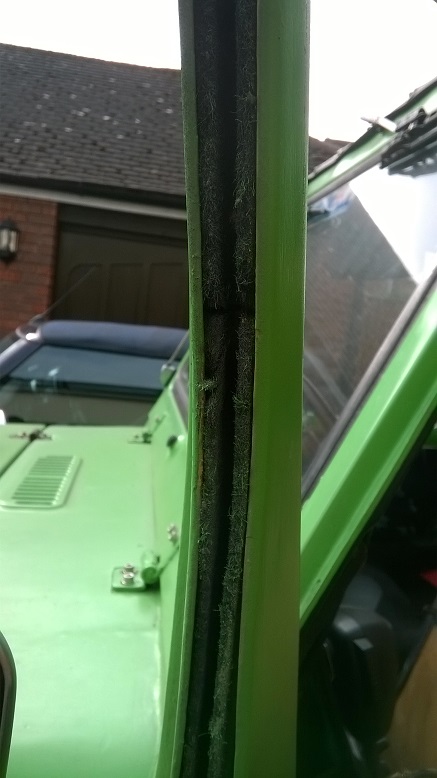

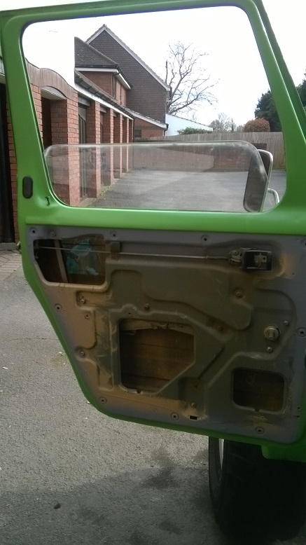

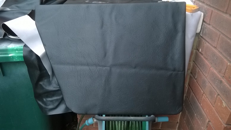

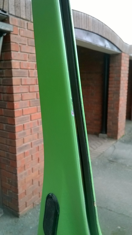

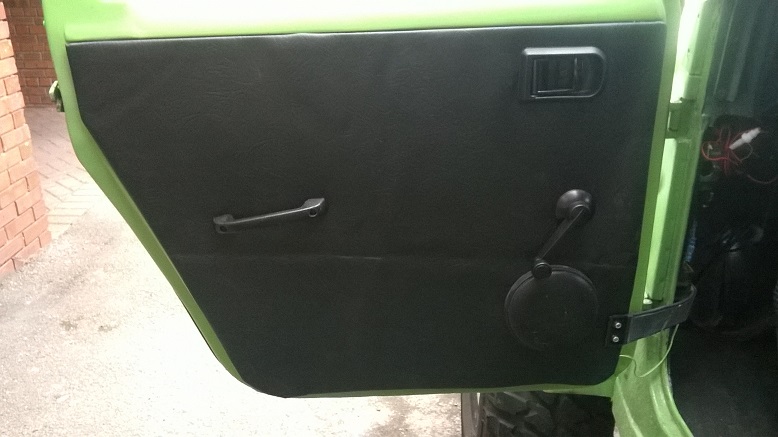

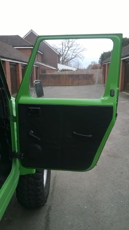

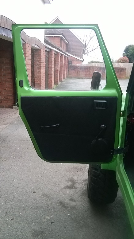

Been busy fixing various rattles and squeaks. Discovered both door latches were not even bolted to the body so I sorted that. Doors should now close properly but no...then a really annoying rattle cropped up and that turned out to be the nearside window glass. Took off the door card thinking the glass wasn't seated on the runner but all was fine. Turned out one side of the door was missing that felt that stops the glass moving when it's wound up. So I made some out of draught excluder and all good now. At the same time the door cards got recovered in black plastic as that camo was getting a little worn.
