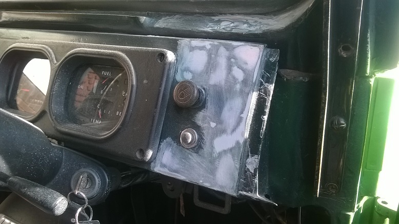

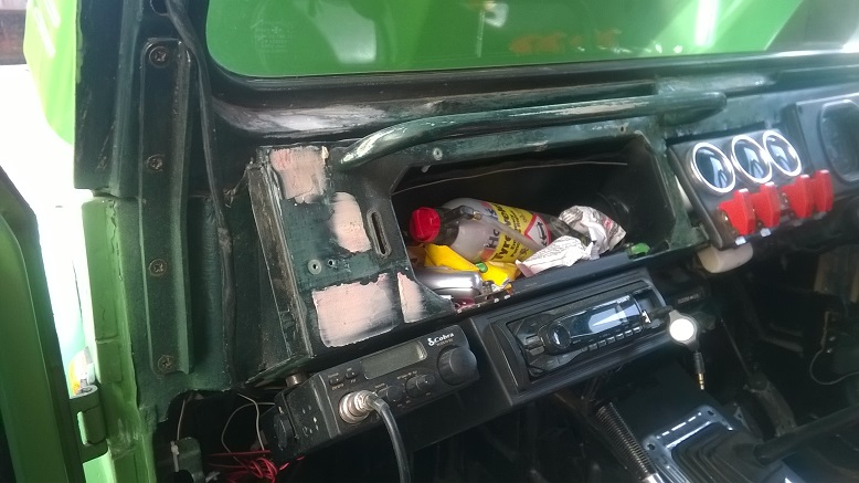

And now some warmer weather is here I am back on the LJ. Fuelled by my success with the window, and not quite with the doors, it's time the bodywork got sorted and properly this time!
Starting with the dash. It's very basic and metal...and full of dents but it's getting there.

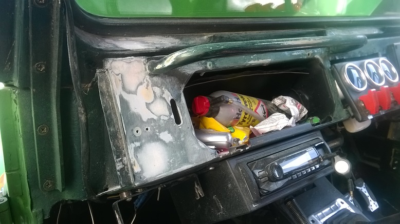

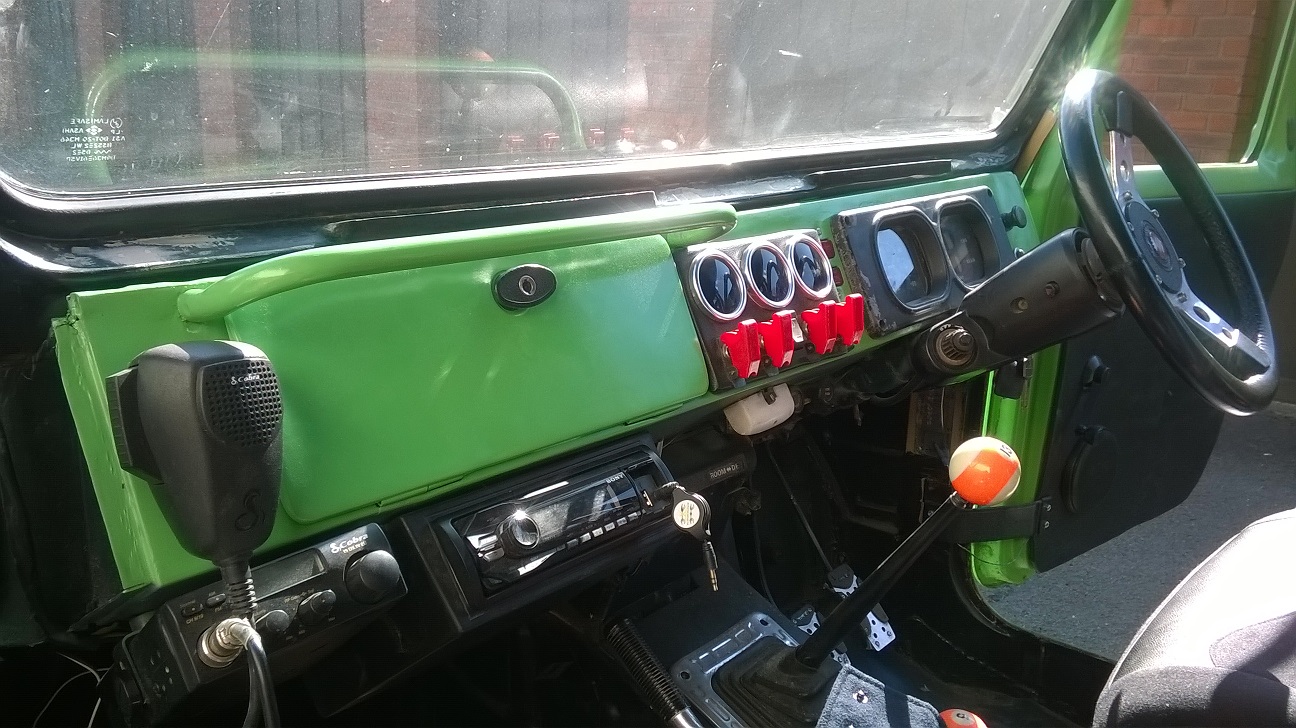

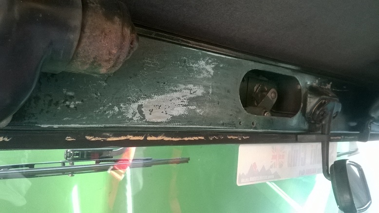

Post by donkeychomp » Sun Apr 02, 2017 10:40 pm
The main part of the dash is done. I am having one problem with a screw that holds the windscreen mount on. Sheared completely and no matter what I do to it (chisel, swearing etc) it won't shift. Apart from the obvious drilling it out has anyone got an easier idea?

Post by SlimGrim » Mon Apr 03, 2017 12:02 am
Damn that looks really smart bud! Apart from tac welding a smaller nut onto the back of it and trying to unscrew it again, drill & tap is probably the only real solution :/

Post by donkeychomp » Mon Apr 03, 2017 9:10 pm
Cheers! Yes I think that the weld a nut on idea is the best way to go. And on the other side too dammit!

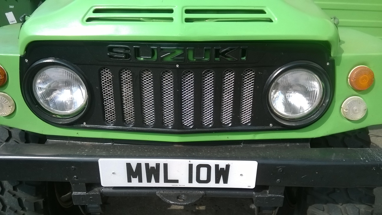

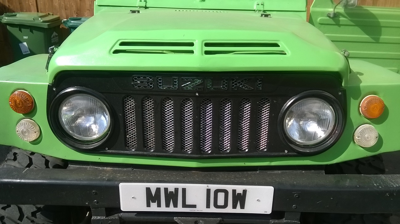

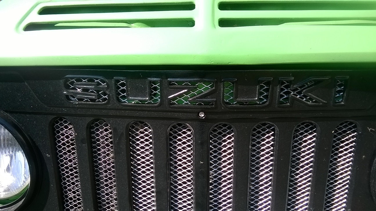

Post by donkeychomp » Mon Apr 03, 2017 11:54 pm
Did quite a bit today. The grill got some new mesh on the Suzuki part. Then it was time to track down a load of annoying rattles and squeaks. Turned out to be mainly the soft top frame. Some areas need R clips, other stuff I used cable ties. Spent most of the day doing it. Drove home tonight in an almost rattle free zook!

Post by SlimGrim » Tue Apr 04, 2017 7:21 pm
that grills really smart in black! Keep it up bud :D
