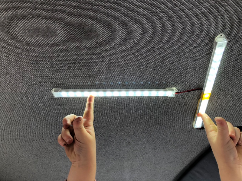

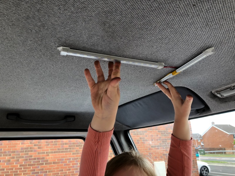

Also crudely part fitted my additional LED interior lights.
Drilled a hole through the roof lining and fed the wires through to the existing light for power, also work on the light switch and door switch.
Just need to get some self tapping screws from work to fix them in place.

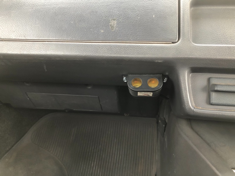

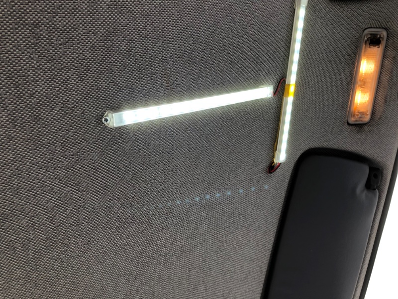

This is quite literally a no expenses spared upgrade into the 21st century.
LED lighting

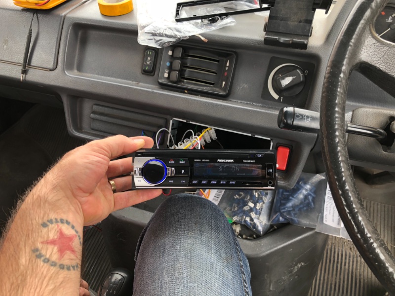

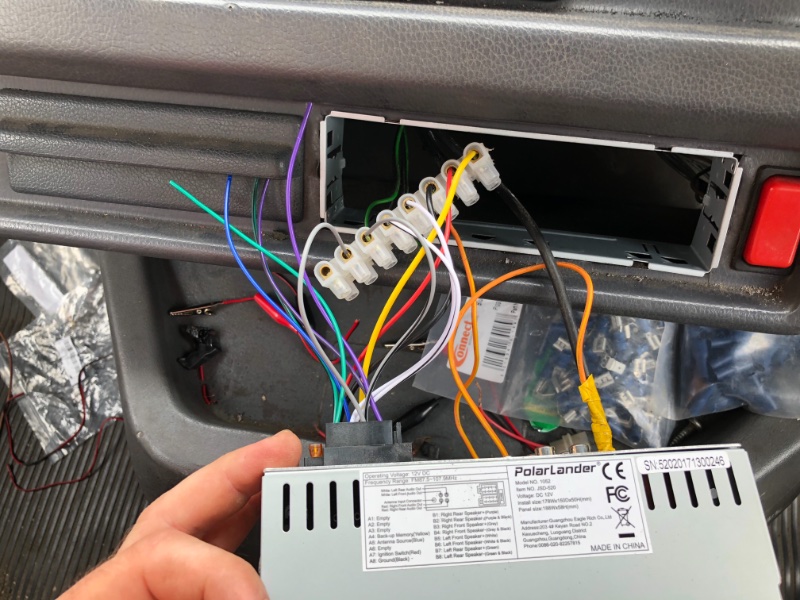

Bluetooth stereo, eBay special £13. Works fine, currently only wired into the 2 dash speakers. I do have a pair of Speakers to fit to the rear wall at some point.
Phone quality seemed ok too, no sure what it will be like with the sound of the engine at 60mph but i’ll find out.
Some 12v sockets i had lying around as it had no power outlets.

Post by Jordi » Mon Jul 23, 2018 5:28 pm
Got some self tappers today and screwed the LEDs in.
Re: My latest common sense failure
Post by ROBBIE » Mon Jul 23, 2018 10:13 pm
Looked better held in place by a small child :lol:

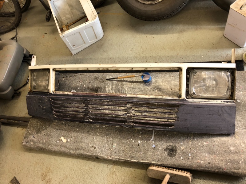

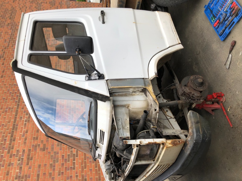

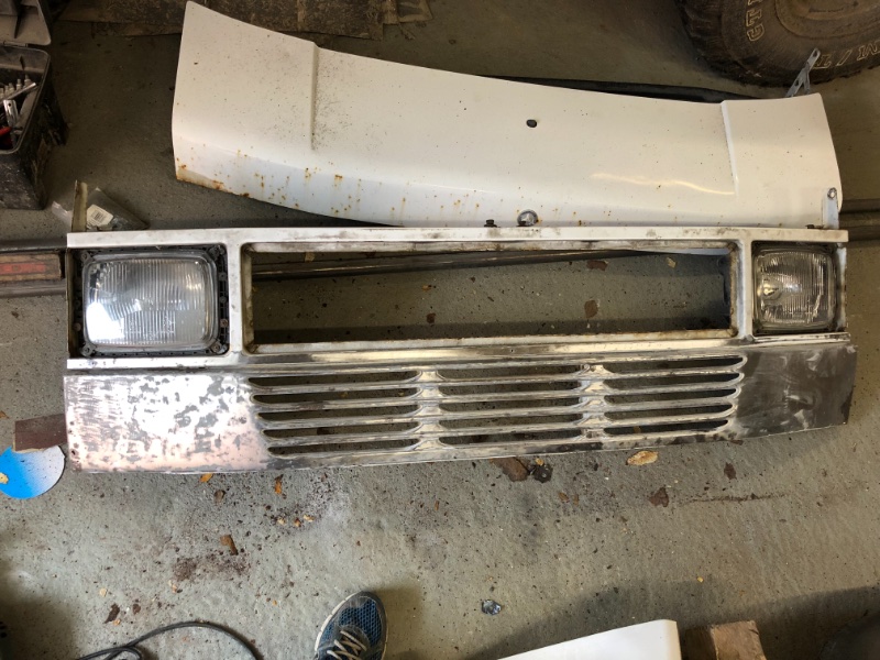

Post by Jordi » Mon Jul 30, 2018 5:42 pm

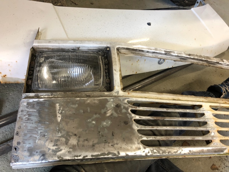

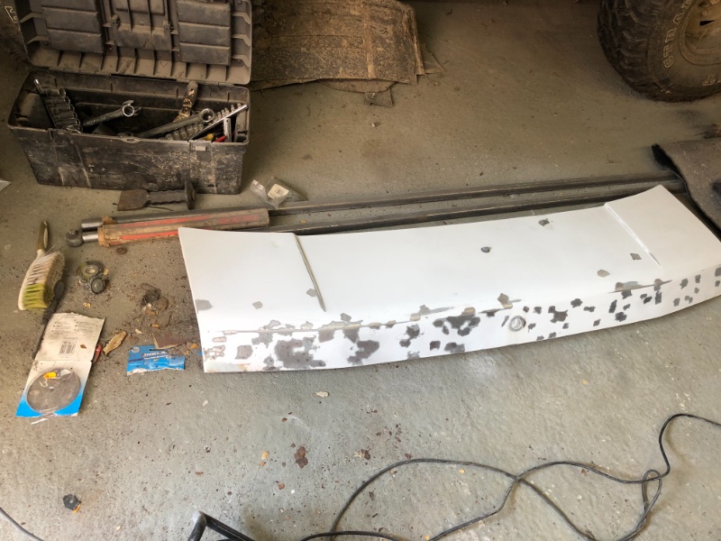

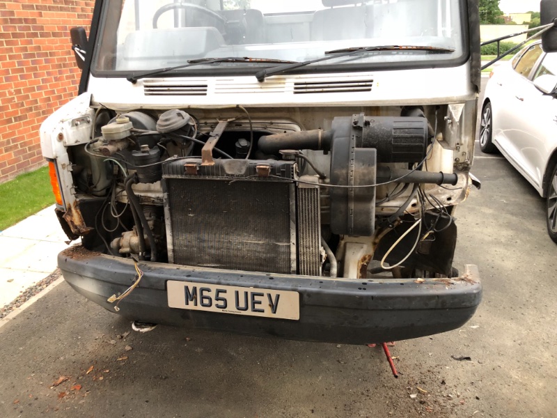

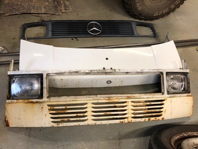

Made a start today on replacing the wings and repairing / painting the grill.
The wing was a real twat to get off, amazing just how sticky seam sealer is.
Hoping the grill will clean up and paint.

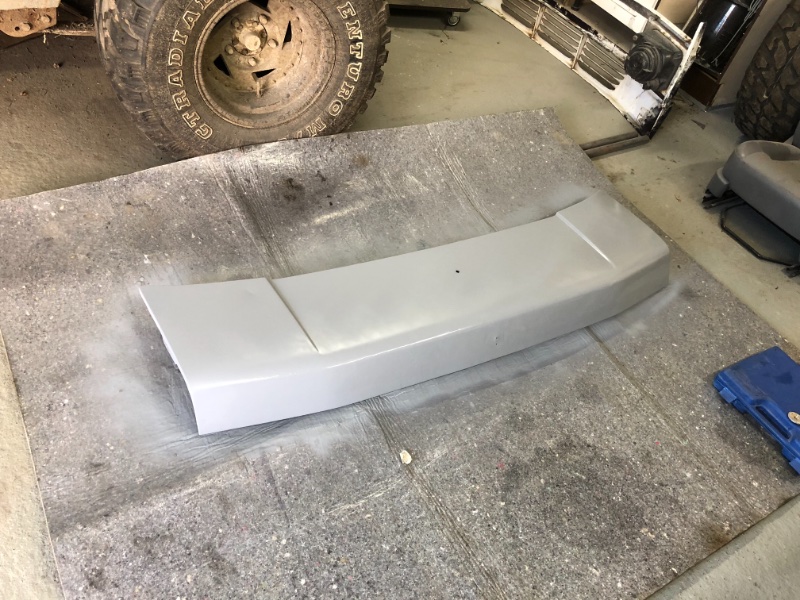

Post by Jordi » Tue Jul 31, 2018 4:12 pm
More progress today.
Post by andyrew » Tue Jul 31, 2018 5:15 pm
Good work dude.
Minimal rust really, good your treating it now.
Compared with transits of the same age it's amazing how well built mercs used to be.
Shame to following vans never got the same build quality.
