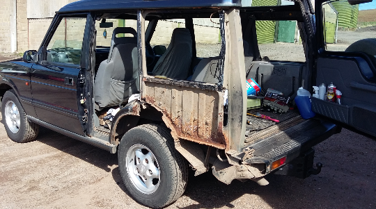

lol top quality fiberglass over rust repair job there
Re: Andys dabble in disco land.
Post by Anton » Fri Feb 24, 2017 3:11 pm
I recently helped a mate fibreglass in a few big holes in an old transit, but we cut the rust out first. Nought wrong with fibreglass in a body on chassis vehicle, as long as you clean up the metal first and seal it so it doesn't just rust from the inside out. Better to weld in new metal, sure - but we didn't have a welder delicate enough (only had an ARC welder that just blew holes through the body the moment you touched it, even on min settings), and the MOT was looming...

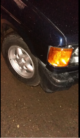

Suzuki 1 : disco 0
Opps.

What happened was , i rolled the zuk out of the barn to back the disco in and as reversing in i swang the front round and the two front corners met and the disco got all out of shape. Zuk was fine.
Straightened out fine, then the following day i was in a really tight multistory carpark and nudged a barrier on the exit ramp and pushed it all out of shape again.

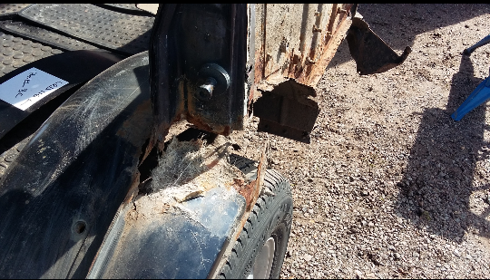

Whats behind the blue door? A shit load of rust i can tell ya!

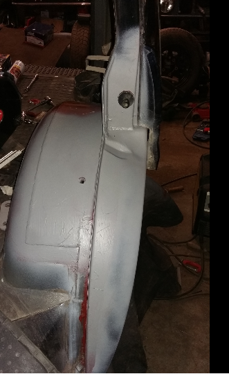

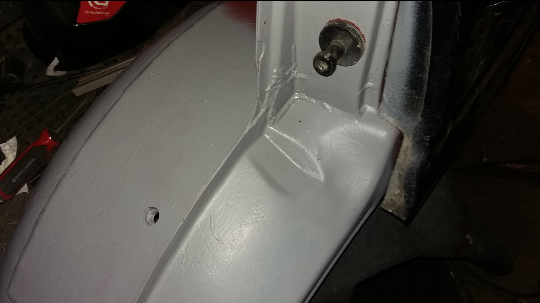

Inner wing repair and new arch panel fitted, just slapped on some primer for now with the worlds crappest paint brush.
Ill dress the corner welds back when i can get some bits for the die grinder.
