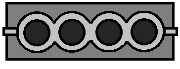

it would be dead easy to make a simple manifold for bike carbs.... couple a bits of plate and some tubes...
i was thinking about bike carbs apart from its not as manageable as injection with charging applications
I would probably try to make a manifold where the tubes to the carbs were sleeved inside larger tubes, then you can make it into a water jacket and have it heated... although icing should be minimised anyway with the straight path the air takes into the engine... might as well do a proper job though ;)
like so?

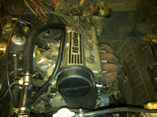

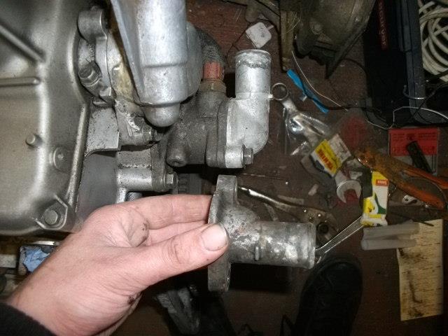

Post by twiss » Sat Jan 11, 2014 10:42 pm
the thermostat housing is at the back of my engine... used a right angled suzuki alto stat housing with silicone pipe to the radiator
