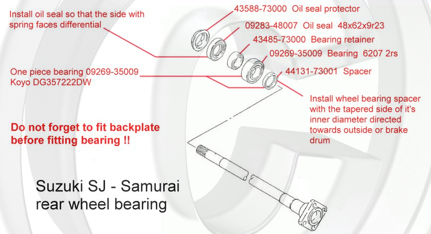

Re: Suzuki sj 410 from Cornwall PROJECT Never Ending Project
A new retaining collar, often part of a kit!dazerede wrote:I plan to do ruf in a couple of mounts but funds is getting a bit low so can't for a while
I bolted a piece of angle metal on too 2 the Drum nuts and I put a car scissor jack in between the spring.and the angle metal and all it is doing is bending the meatal I gave up for the day about 2 hours ago but I.will have a better go tmoz
What do I need to get to do the rear wheel bearing
Wheel bearing
Spacer
Oil seal
Maybe a brake pipe spanner, unless your backplate has the section that comes out.
A ordinary spanner may do, but once the nut is rounded off its a pain.
A angle grinder.
Access to to press.
- mHX1oYyTNWl3xSJKj5t0deg.jpg (6.8 KiB) Viewed 6354 times
- Rear wheel bearing diagram.jpg (365.94 KiB) Viewed 6354 times
