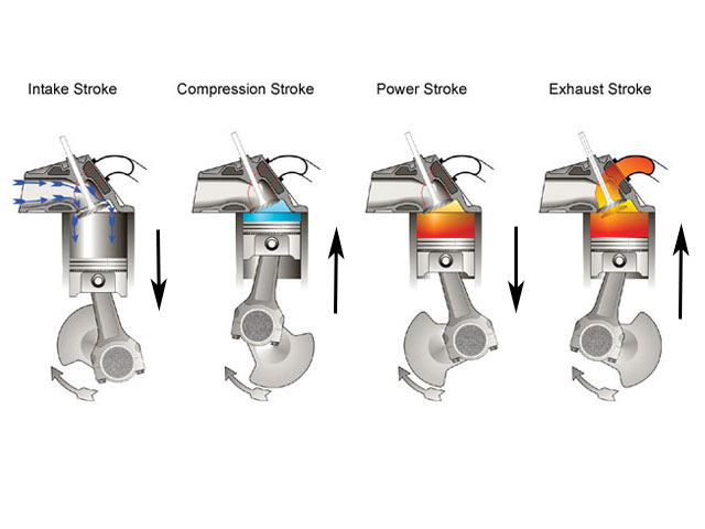

This timing issue has cropped up a few times now, here and other forums. So I have photographed this from the workshop manual. The main problem seems to be setting the timing 180 Degrees out on the exhaust stroke instead of the compression stroke. As the manual instructs you to take the rocker cover off to make sure the number 1 cylinder is under compression (rockers not touching valves). But who wants to do that and bugger up another gasket ??
I would suggest removing the spark plug and offering a short length of a suitable size hose into/onto the plug hole. Then try blowing down the hose, if it's hard to blow down then it's on the right stroke. Likewise if it's easy to blow down then turn the engine 360 degrees and try again!
Of course make sure everything is really clean so as not to allow any dirt to enter the cylinder
I've not tried this, so any input would be good. At the end of the exhaust stroke (10degrees before top dead center) is the exhaust valve still open a little if not this theory wouldn't work.
