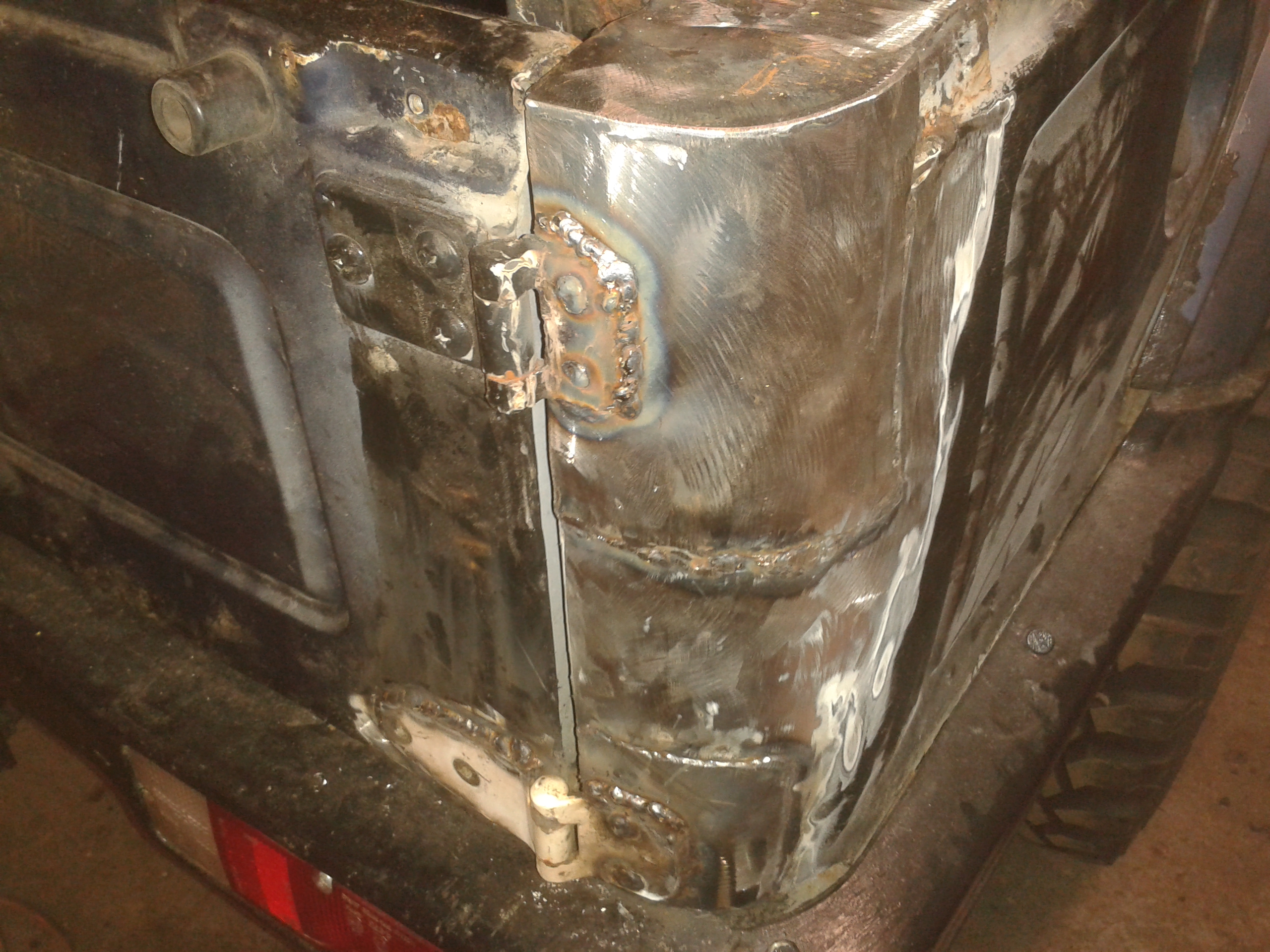

Post by andyrew » Tue Aug 06, 2013 12:54 am
It aint pretty but I have a door that works!
Ive just plated over the top for now and welded the hinges on. The lower hinge was dead
So I just boshed on a front door one. Its solid but ugly. Welder keeps on faffing me about
So the welding isn't as nice as I would have liked . Screw it I have a door !
Post by dan_2k_uk » Tue Aug 06, 2013 1:00 am
At lefast it wont fall off!
