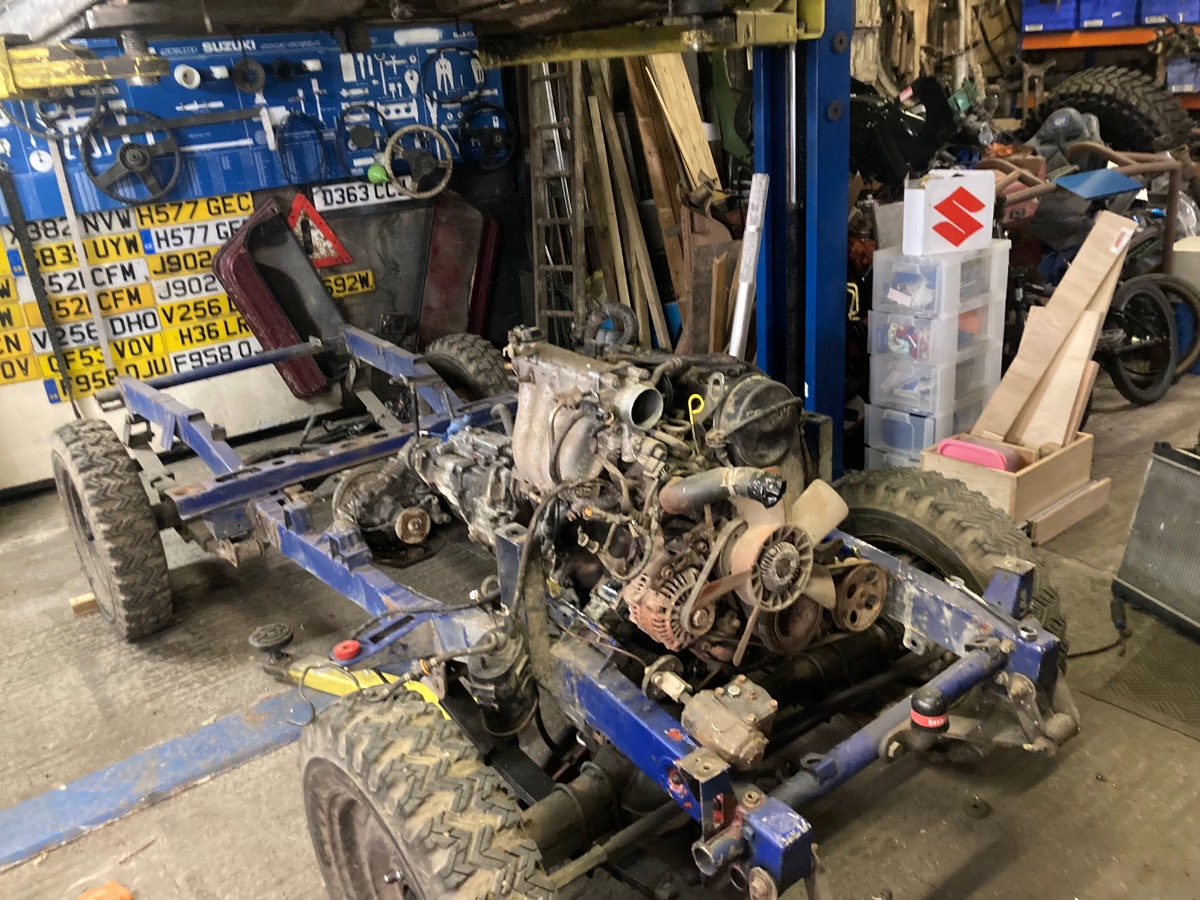

It’s been cold, too cold to paint the LWB so while I was waiting for the weather to warm up I pulled blue back out, pulled the j20 and dropped in the G16 16v.

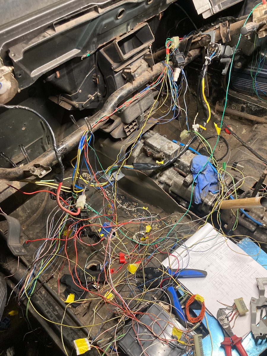

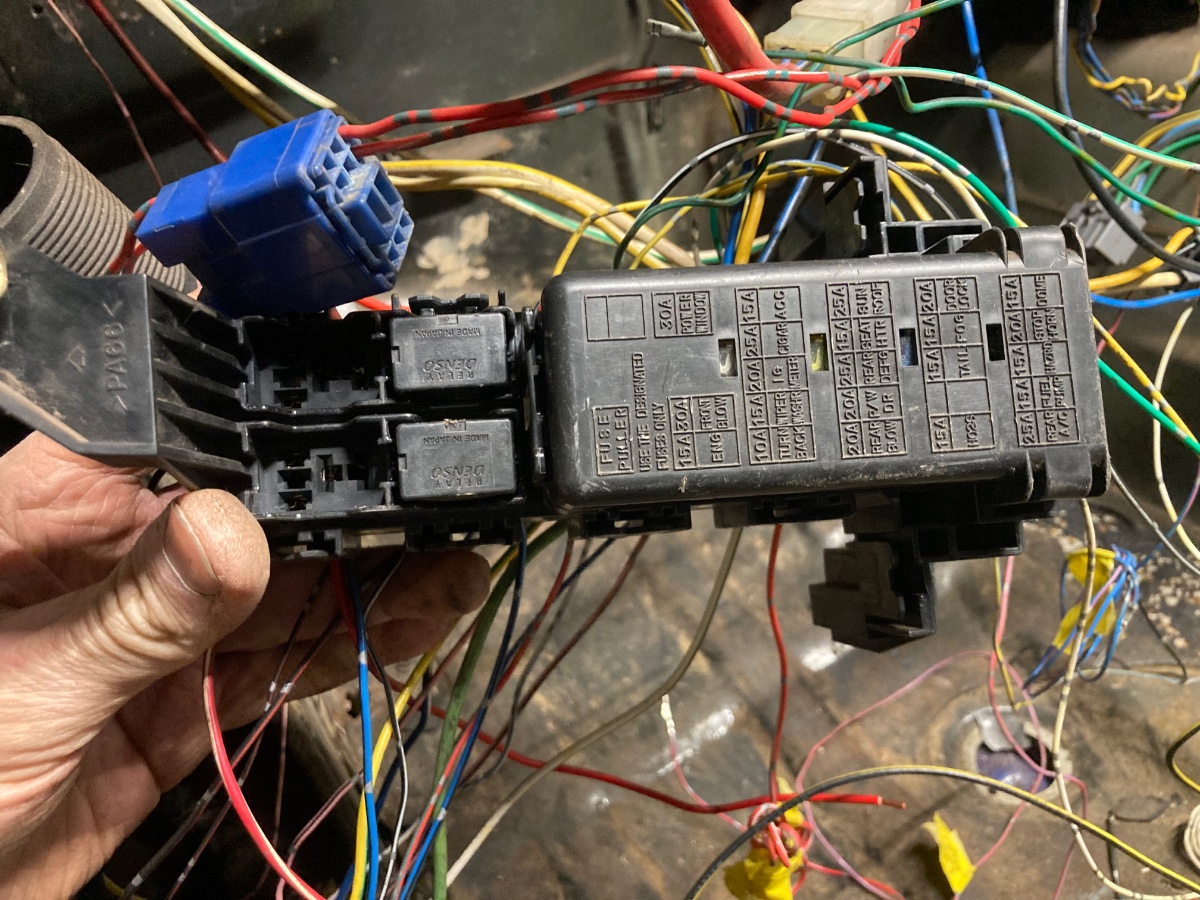

Then I had the grand idea to use the GV power distribution/fuse box so I’ve ended up ripping both looms apart to build a whole new loom for blue :lol:
Should be good in the end as I’ll have relay switched headlights so less voltage drop, a nice big power feed to the heater motor, 2 things that always suck on SJs!
Haven’t finished the loom yet and it’s starting to warm up now so back in the corner blue goes while I finish the lwb.

Always so rewarding when you get the wiring buttoned up and it works
