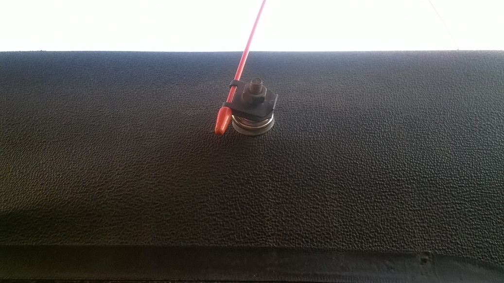

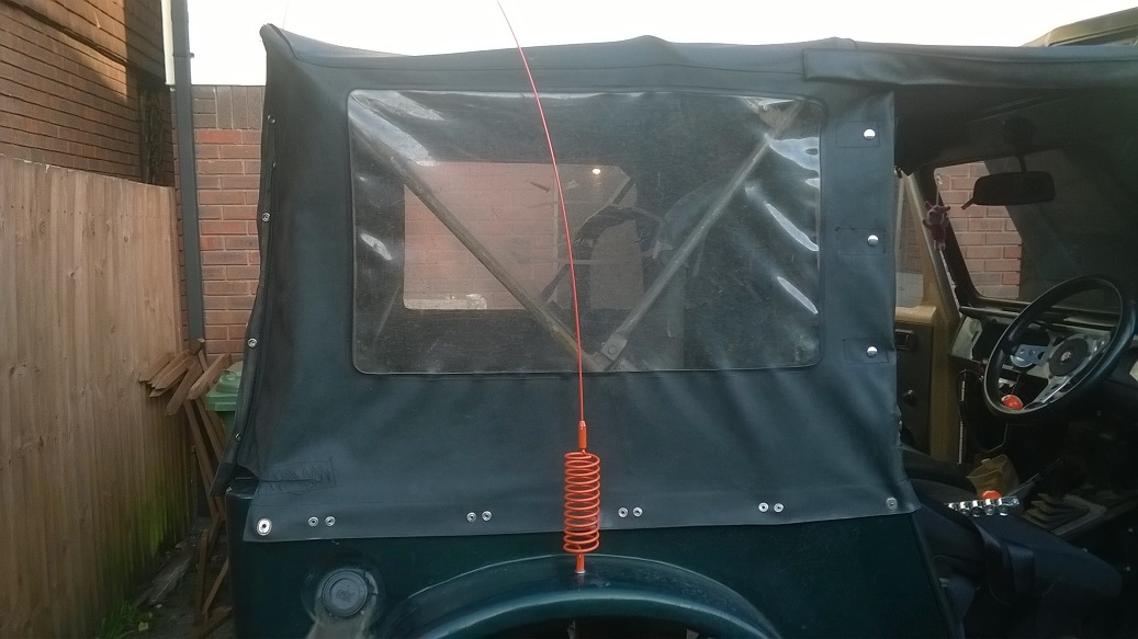

The blue LJ (P5) is done now bar the steering bits, green one (P6) has a long way to go though. Only had a spare hour today but fitted the aerial on the rear wing and made a neat thingy to hold it down to the roof (piccs tomorrow). After getting 2 rolls of door seal in the wrong size I ordered a metre of different stuff. Turned up this morning and it's spot on so I've ordered more to finish the car. Seen a winch on ebay (Superwinch 12,000lbs) but can't afford it until P5 is sold. Hey ho!

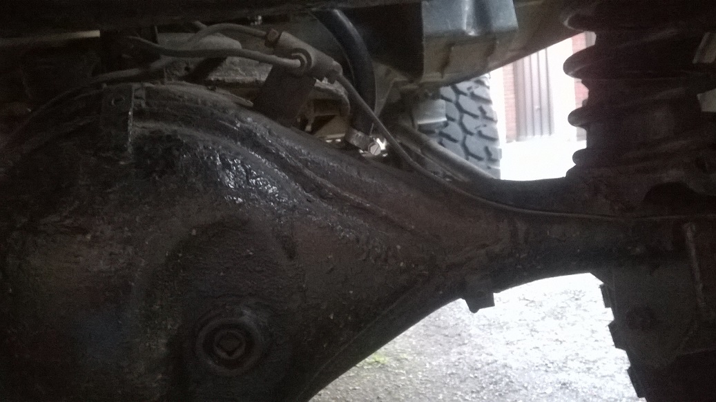

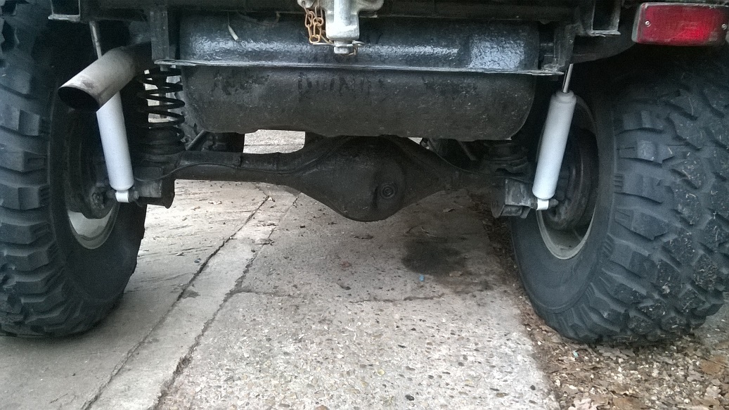

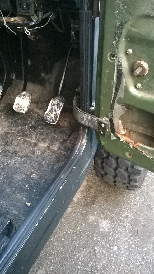

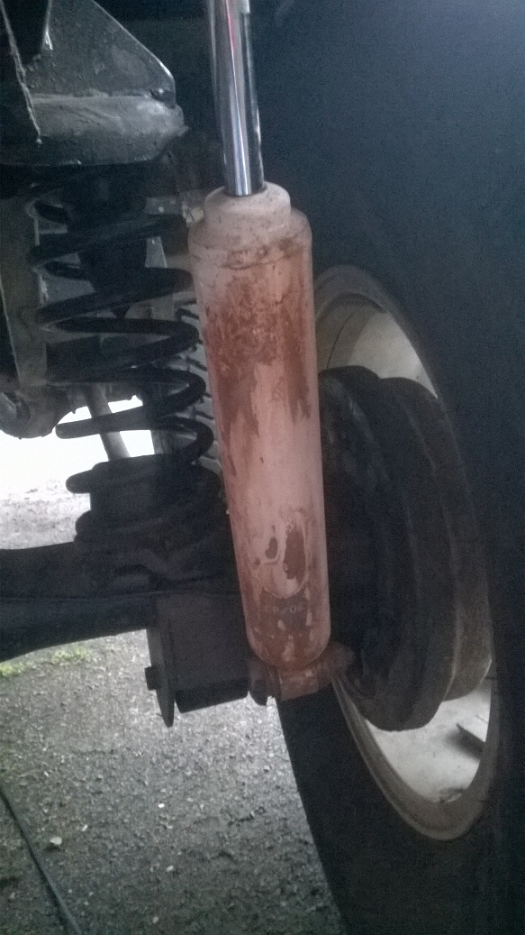

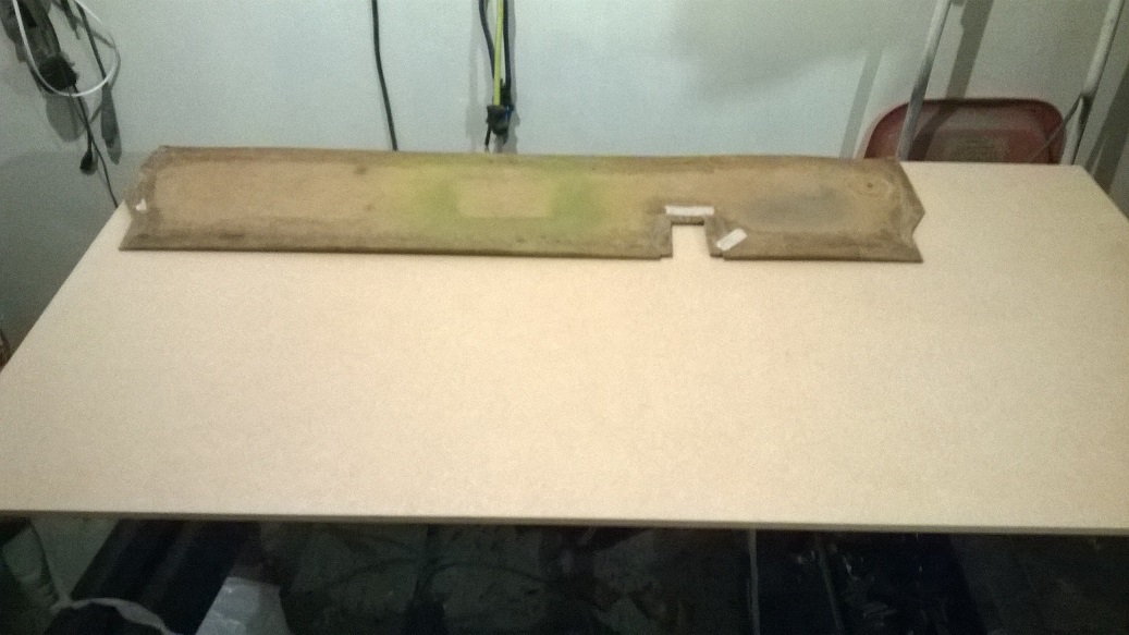

Rear door card is knackered on P5 and P6 doesn't have one so I'm making 2. Diff breathers are on, and I've done the rear shocks...well I hope I have, ended up finishing them with a portable heater and a torch, got a bit dark! Got a sample length of door seal and it fits so ordered the rest, the lip is 8mm wide, kinda surprised me...

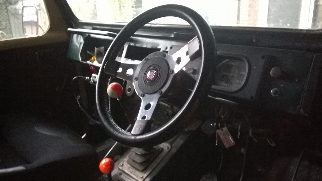

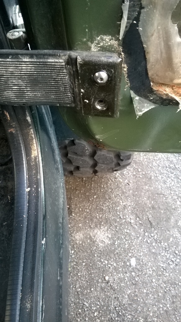

Few more bits done...passenger seat is now in...lots of drilling but all good now. The winscreen wiper motor is FUBAR. Keeps on missing it's parking point, and only covers about half of my side of the screen...not a good thing. Scottie thinks he may have one, fingers xxd. High steer kit arrived today, a serious piece of kit, very very strong and well made. That will be on next time I get a day off..so 2016 then. Maybe summer. Another roll of door seal came too but the passenger door won't close with it on, headscratcher this on as it worked fine on the other side! Changed the Astrali to a smaller Mountney as I was having trouble getting out...the wheel was too big and kept on trapping my arse as I tried to get out...lol. And the late night respray of the shocks worked just fine.
