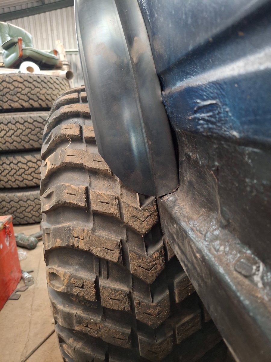

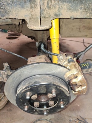

Managed a few hours today at the garage, got the rear brakes plumbed up and fitted a extended flexi from the chassis to axle. Also got some rear arch and bump stops fitted.
They cover the road wheel's completely but not the offroad ones. Was a option for 100mm but went for 70mm

Bit of a carry on but the brakes are on and have given them a quick bleed still need another go probably. I've also went back to a standard brake servo.
4 diy bumpstops fitted to the previous person's spoa perches, changed my fuel tank just filters to swap again. Then it should be ready for a day out on 20th
