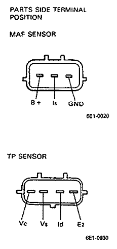

OK so mine is a late model vit with an early model hot wire MAF sensor with built in IAT sensor
You can see the IAT sensor inside the MAF sensor pipe.... duh!
I haven't got the immoboliser model number on me but will check it on my next trip out to the garage
I have the MAF and TPS connectors from section 6E1-3 of the later immobiser manual...
Can you tell me how these relate to vref, signal, and ground (for the TPS) and any idea what B+ and Is connect to? I'm guessing one is temp and one is MAF?
- sensorpinouts.png (19.12 KiB) Viewed 5400 times
Re: Twiss' supercharger+EFI
MAF:
B+ is battery
Is is signal
TPS:
Vc = 5V
Vs = output volts
Id = idle
E2 = gnd
B+ is battery
Is is signal
TPS:
Vc = 5V
Vs = output volts
Id = idle
E2 = gnd
