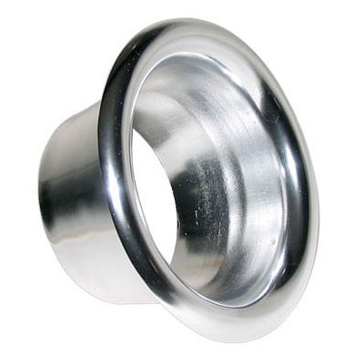

and i was going to use these:
but not far off about £6 pound each pluss postage i thought that was a bit extreme for my liking , so all of a sudden my old man had a brainwave and it was cheaper to by to downlights nick the bit off the top and chuck the rest and the neighbours dog , the guaze is from fleebay about a quid each and this is the end result
