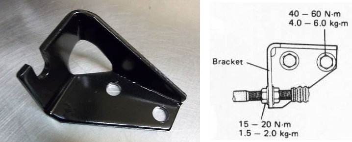

Hey guys,having a bit of trouble with my clutch cable
we put the 1.3 in the 410, is there ment to be a bracket on the side of the engine to bolt the clutch cable onto? and can i swap the arm off the old gear box onto the new one so i dont have to change the cable end?
in the book it says there is a bracket but i just cant see it on either of the engines?
cheers guys :thumbup:
Re: Cant seem to find where to mount my clutch cable
Post by Jordi » Sun May 31, 2015 2:33 pm
Yeah. Should be a bracket on the side of the engine.
Not sure if 410 and 413 gearbox arms can be swapped though. Just try it.
Post by Darrell » Sun May 31, 2015 3:00 pm
Your looking for this.....
clutch cable bracket.jpg (34.01 KiB) Viewed 6158 times
Post by gamble63 » Sun May 31, 2015 6:49 pm
ahh that would make a lot of sense, i dont know how ive managed to loose one off the 1ltr and the 1.3ltr .
Scottie if you did have one would you be up for selling it to me and the 2 bolts if you have them?
then im just short one shitty rubber mount for the body and it should be up and running :)
cheers for the help guys
