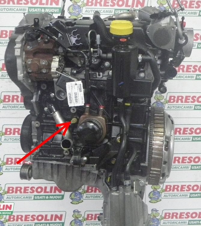

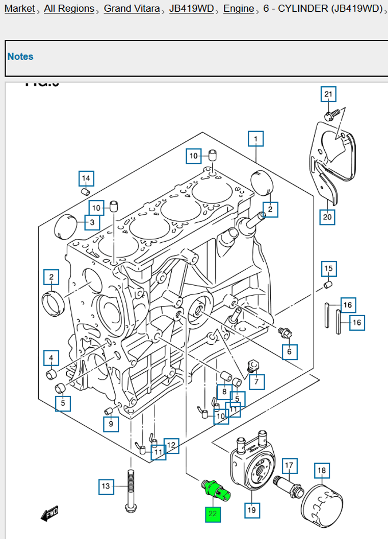

Hello everyone,
Im new here so pls be gentle on me. I just wanna ask you guys if you know wheere is the location of oil pressure switch on 07 suzuki grand vitara 1.9 ddis. I've been looking everywhere cant find an article about it. Thanks in advance.
Suzuki JB419 oil pressure switch location.png (252.93 KiB) Viewed 6467 times
JB419 oil pressure switch.jpg (407.87 KiB) Viewed 6467 times

Darrell wrote:Welcome to the club.
Hello Darrell,
Thanks a lot thats a big help. i appreciate it. many thanks.
