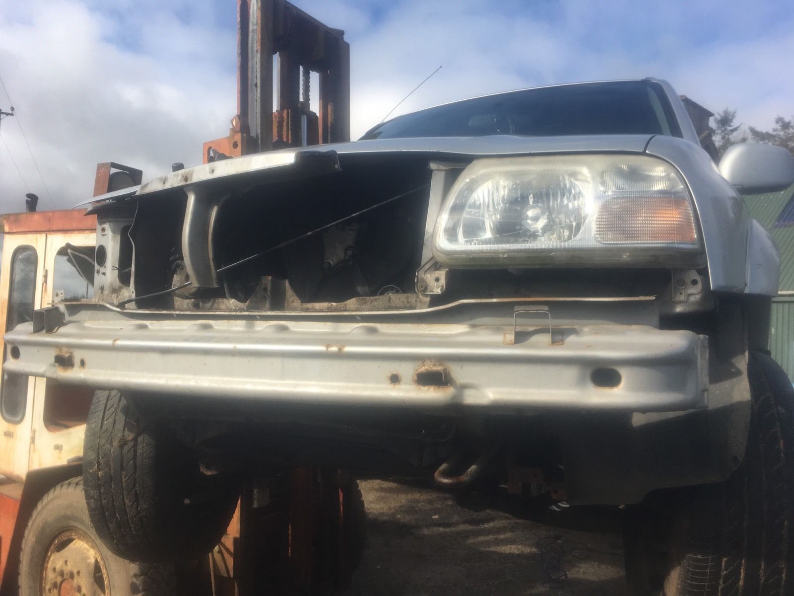

Re: Number Plate
Post by Darrell » Mon May 01, 2017 11:05 pm
Not sure how to fix that. Behind the plastic cover is this..
I'd have thought just screwed to the plastic it would wobble about.
It may be possible to drill right through and bolt but would probably need little spacers between the metalwork and plastic cover, not too difficult though.

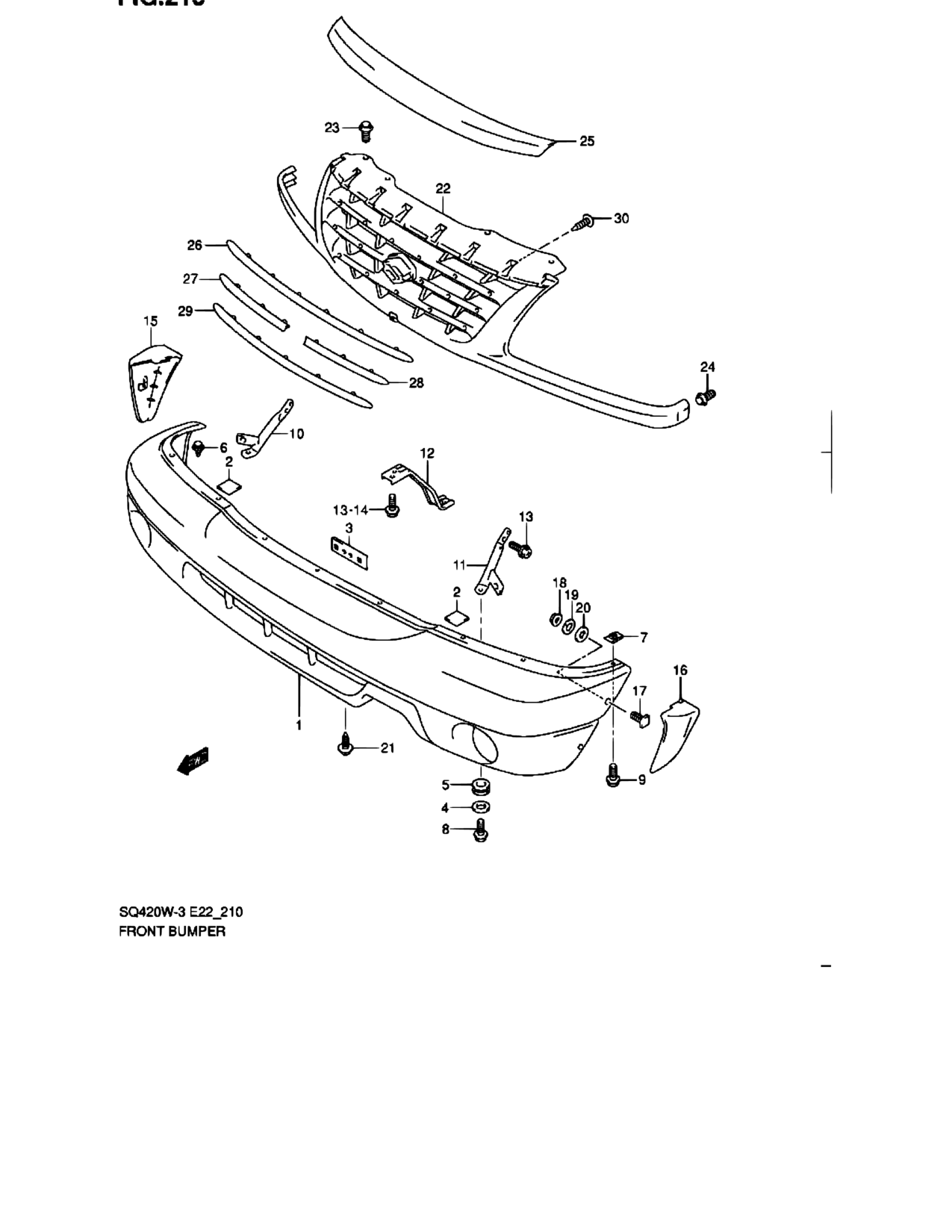

Post by Darrell » Mon May 01, 2017 11:11 pm
I see there is a licence plate retaining plate on the parts list (3). I assume this is bonded to the rear of the plastic :hmm:
