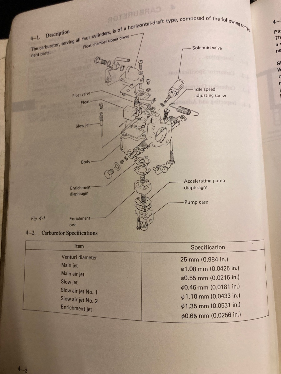

Post by ScottieJ » Fri Dec 13, 2024 10:15 pm

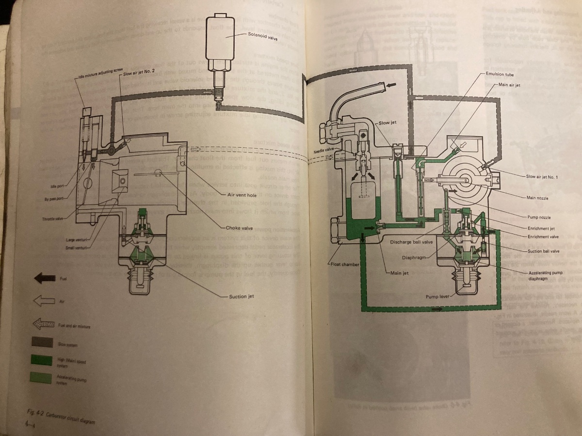

I’ll take pics/scan the carb section of the sj410 service manual for you on Sunday or Monday and post them up for you.

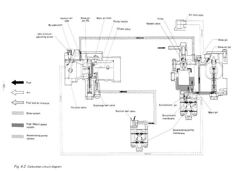

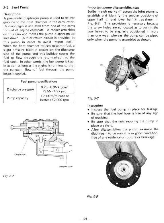

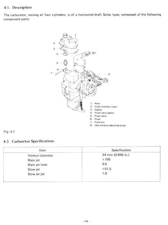

Hi from New Zealand. Unlikely to help as it's for a LJ80 but here are pages from sections 4 and 5 of a manual - Carb and Fuel related.

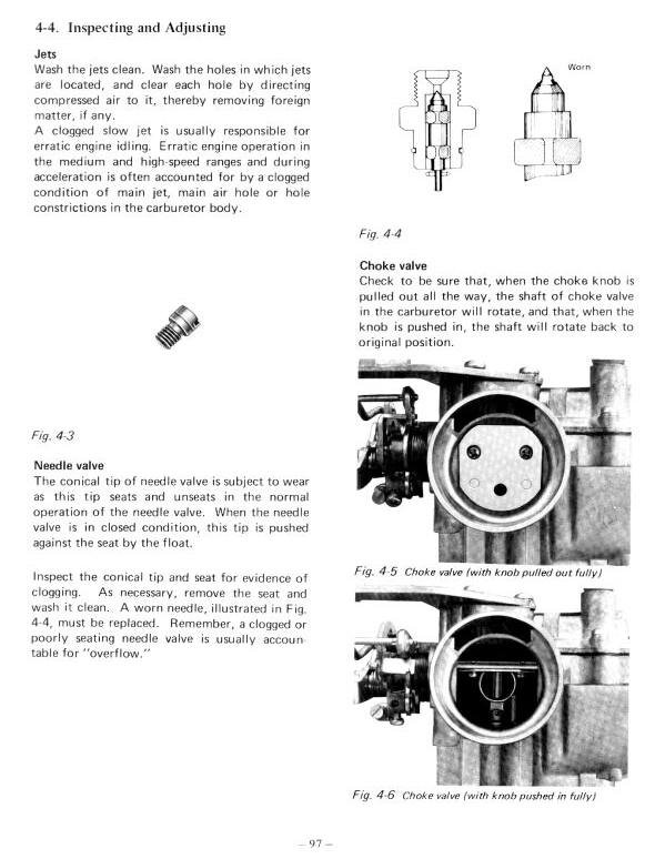

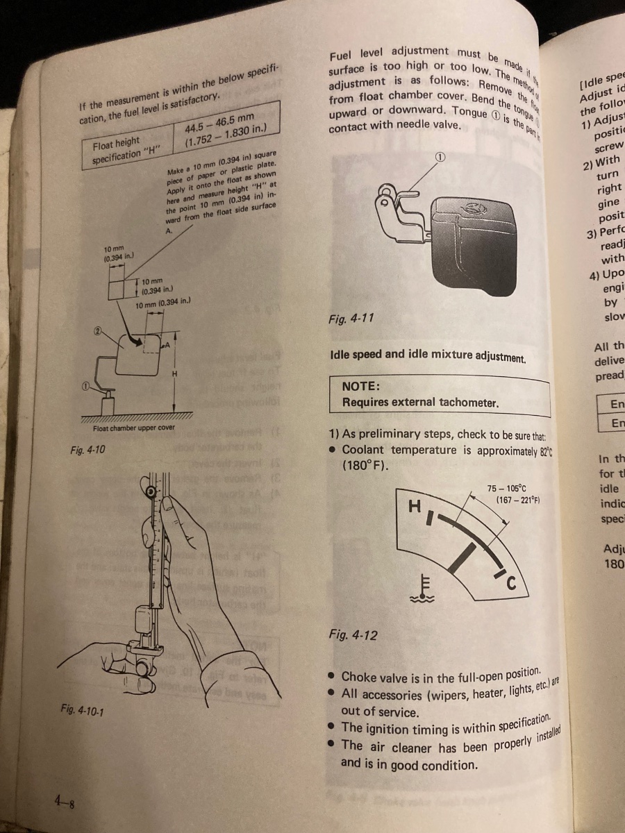

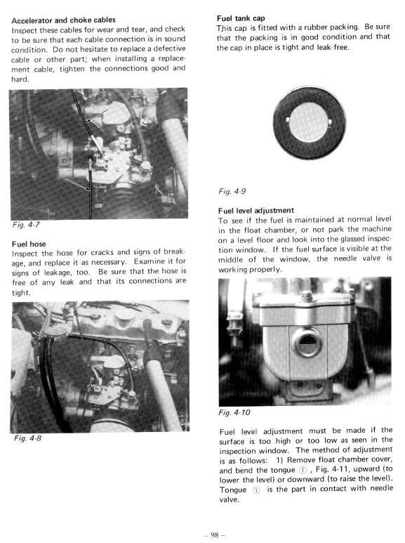

Post by ScottieJ » Fri Jan 03, 2025 3:53 pm

Post by Som17y » Fri Jan 10, 2025 11:58 am
Thank you very much for the info. I'll have a read through
