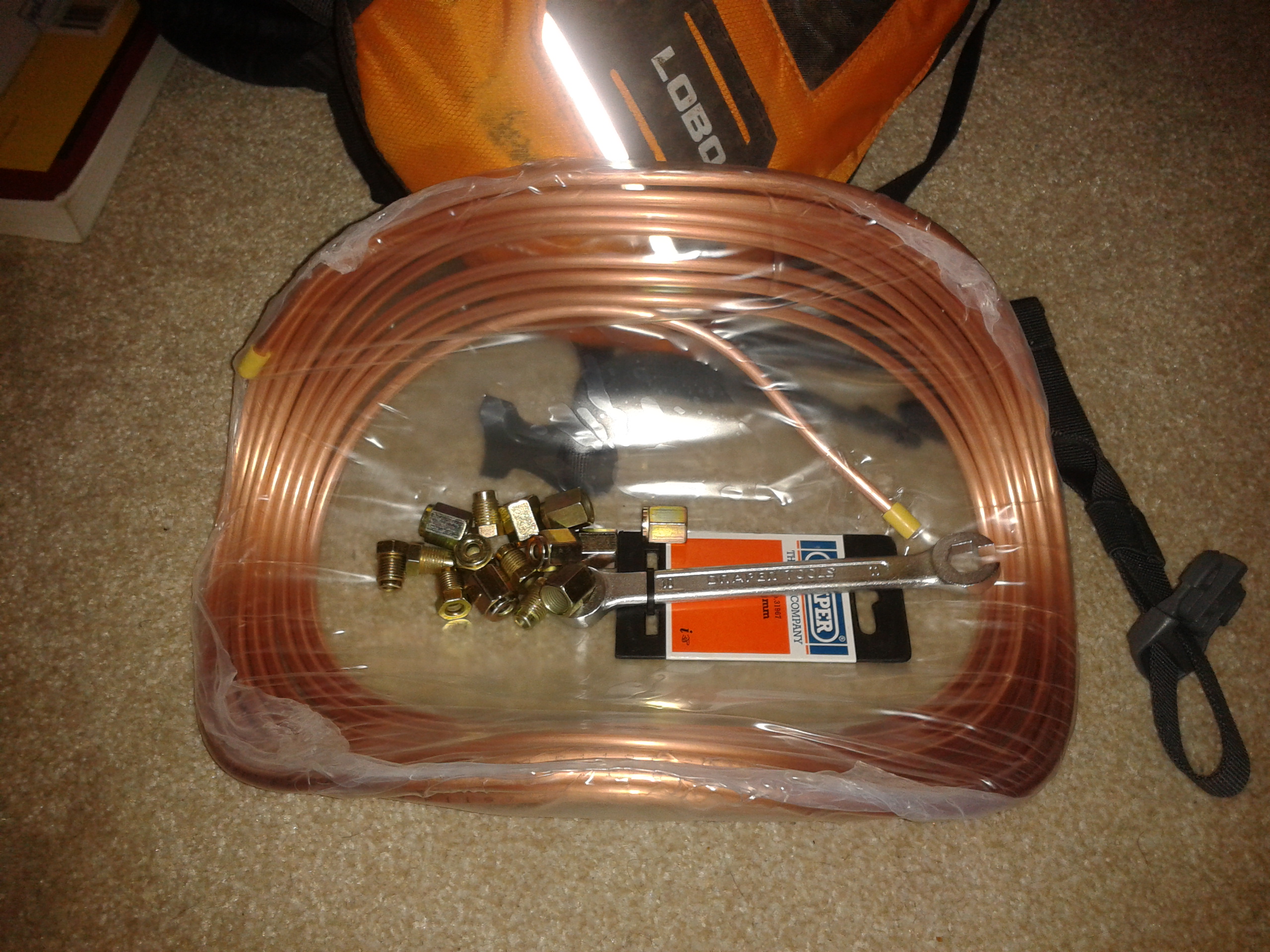

All my brake parts came today, all ready to fit this weekend. One question though, it's probably blindingly obvious, but how do the fittings fix onto the pipe?
2012-02-29 21.08.02.jpg (1.5 MiB) Viewed 11516 times
Now a build in progress
Re: Brake Pipes
Post by Darrell » Wed Feb 29, 2012 9:42 pm
You need a pipe flaring tool. Something like this............

Post by ianedwards » Wed Feb 29, 2012 9:56 pm
oh, yea like above you need a flaring kit. ebay or any half decent motor factors will carry them.
basically all you do is,
cut the pipe to size allowing extra to flare the ends,
de burr the cut end,
slide the brake connection on the the pipe, thread towards the cut end,
put it in the correct hole in the clamp, with the right amount sticking out the top
place the black flaring thing in the end of the clamped pipe
slid the spike thing over the clamp
place the spike thing in the black flaring bit and do it up
this will flare the end ,
undo and walah one flared end.
excuse my words but i cant remember what the bits are called.
Ian
