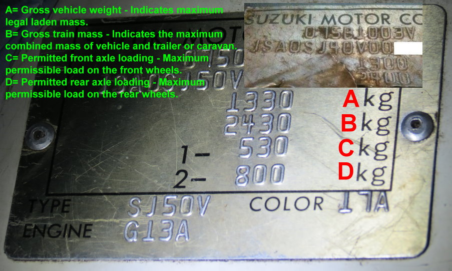

i have my vin plate, just. part of it is missing and i need to know what else is supposed to go on it so i can order a new one...
and what does the "075B1003V" mean and the "2400"?

i think ill just get the new one with what i can see on it like you say as long as the chassis number is there itll go through a mot...

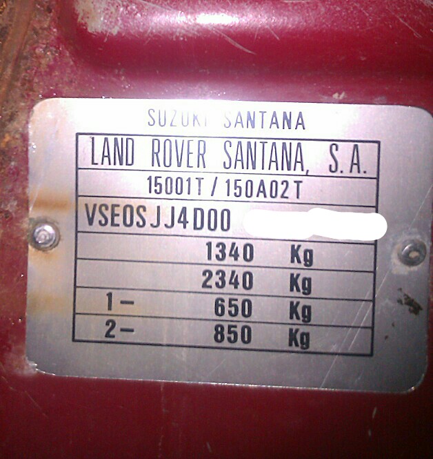

Just been and took a pic of mine :thumbup:
Neighbours must wonder what the hell I get at :oops:
Suzuki VIN plate.jpg (147.69 KiB) Viewed 8610 times
I guess mines 30kg more up front being the 1300cc.

My vin is different to that but contains the same info (well the important things) Mine is Spanish and legally can be weighted more on the front axle! No idea why!
