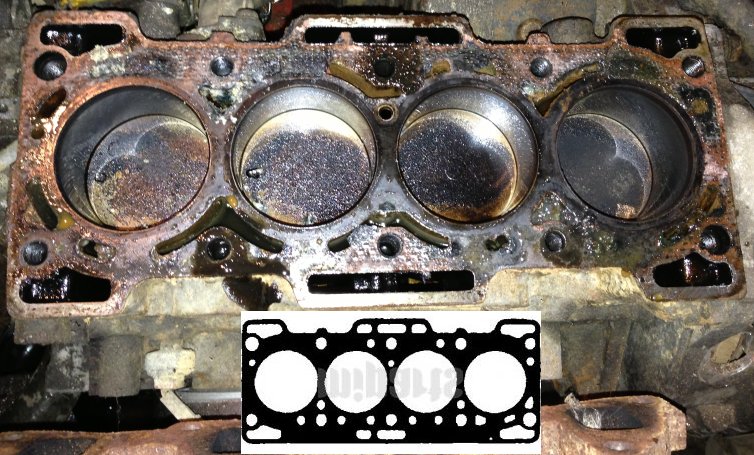

Hi all, due to lots of smoke, poor starting and only running for short periods of time I have removed the head from the LJ so I could have a look around it. I found that some of the water ways were blocked from where the gasket had dissolved into it, should this be happening or is this the likely cause of the problem? pictures below should help me to explain. :doublethumbs:

Looking at a new gasket, I'm going with yes.

Ok thanks for that, it does look like I also had few blocked that shouldn't of been :thumbdown:
Re: Should the head gasket block/cover waterways?
Post by ScottieJ » Tue Oct 16, 2012 11:58 am
It's quite common for them to end up looking like that! I've just done a headgasket on a suzuki carry f10a that was in a similar state!

If the iron block looks that bad I'd check that the alloy head waterways arn't badly corroded, I've had a couple where the waterways were in pretty bad condition. Apparently the early SJ410 Santana heads were prone to it, but never had any spanish built SJ's so can't speak from experience. (What else can you expect from something out of a Land Rover factory!!!)
The blocked waterways shouldn't affect the running initially but it may overheat if theres not enough water circulation. There are products for cleaning out the coolant system ie Radflush. By the way when you refill with anti freeze, the pink long life stuff isn't suitable for older vehicles, apparently. Just found out after I been running round with it my Morris Minor for 6 months. Don't know why and neither did the bloke at the motor factor either. I would also reverse flush through the coolant system,radiator etc with a hose, and i would also remove the thermostat and flush it that way as well
Incidently your engine is an 800cc you can tell by the pistons, 970 ones have indents directly below the valves.
I know I've already said but just throw the 800 lump away and get a 970!!!

yeah funny enough my santana had corroded water ways in the head when i done the head gasket on it. i use a stronger anti freeze mix now to help prevent it getting any worse
