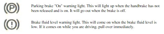

Re: Brake light on dash
Post by Darrell » Thu Oct 25, 2012 9:09 pm
Which one is it.......
dash lights.jpg (16.91 KiB) Viewed 7787 times
Post by turbo-tom » Thu Oct 25, 2012 9:13 pm
mine is the p one!

Mine just a circle that says brake
Post by Darrell » Thu Oct 25, 2012 9:24 pm
TT you post away :thumbup: :thumbup:
The one with the exclamation mark in the middle should light up until the engines started and then go out.
Well that's what the book says but mine never has :er: , still I know it works as I just raise the cap off the reservoir now and again and check.
