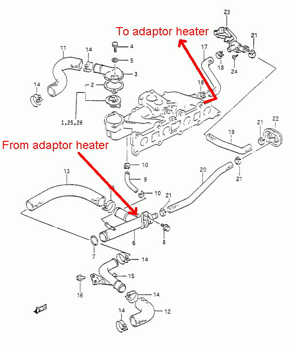

Post by Darrell » Sun Dec 09, 2012 9:35 pm
Any use ;)
SU adaptor heater plumbing.jpg (67.37 KiB) Viewed 4441 times

Post by Gardiner » Sun Dec 09, 2012 9:42 pm
But I am now using the 1600 8v minifold with only one pipe at the end !!!!
Re: SU Heater
Post by Darrell » Sun Dec 09, 2012 9:59 pm
Bugger :S
I would suggest teeing off the heater pipe (17) would be the simplest option.
I,am not sure where the 1600 carb model gets it's hot water supply from. I've seen the write up for the heater jacket and it shows it comes direct from the manifold IE: no hose and therefore ideally be built into the adaptor, but a coil is easier.
