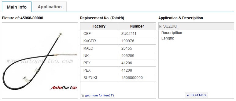

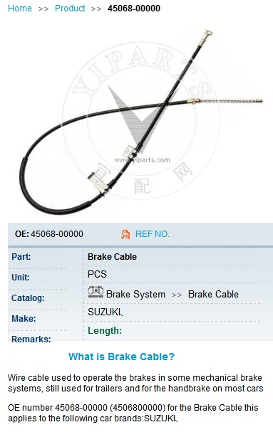

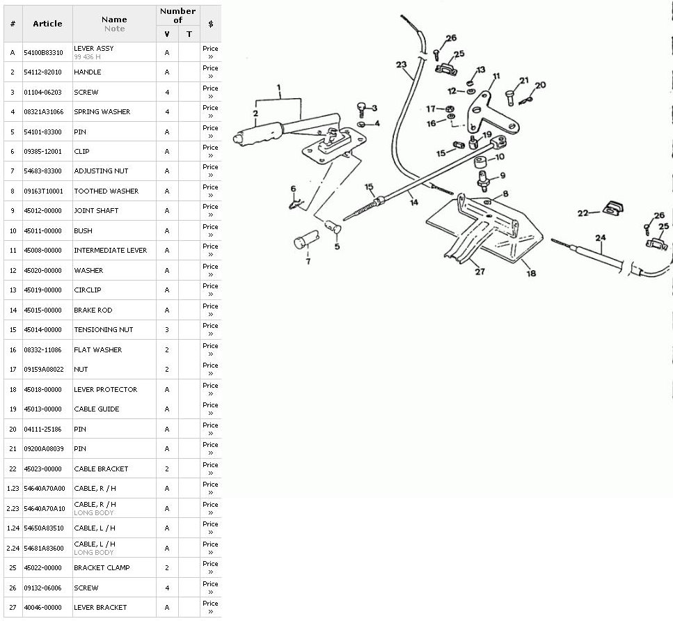

Post by Darrell » Tue Jan 22, 2013 11:13 am
Using "Redlines" main website search engine it says a QH 2839
Cross reference comes up with suzuki 45068-00000.
"Redlines" ebay number for a QH cable doesn't exist :er:
Hope this lot is some help
Handbrake setup 3.jpg (107.42 KiB) Viewed 8868 times
45068-00000 (2).jpg (64.57 KiB) Viewed 8868 times

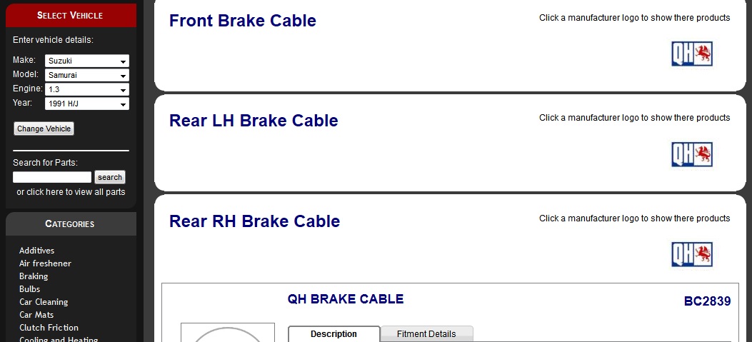

charger
Posts: 201
Joined: Tue Jun 28, 2011 8:26 am
Location: Newcatle Under Lyme Staffordshire
Re: Handbrake cable help again
Post by charger » Tue Jan 22, 2013 1:00 pm
If you punch BC2839 into there ebay page it bring sup the one I ordered & don't fit on the handbrake just the drum.

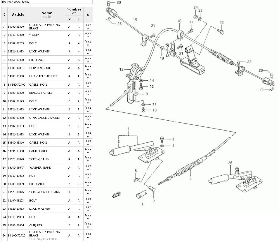

Post by Darrell » Tue Jan 22, 2013 7:04 pm
Only found one half decent pic

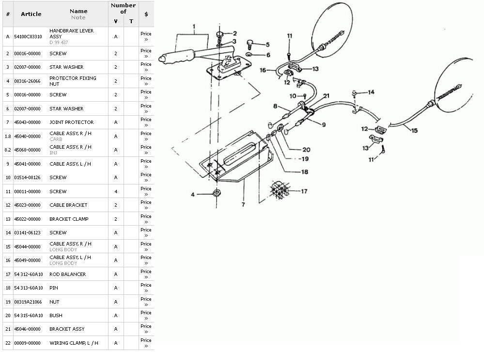

Post by charger » Mon Feb 11, 2013 12:39 pm
Darrell wrote:Only found one half decent pic
Is this cable for the sammy, the one I get sent had an adjuster at the end not that drum looking type thing.
My cable goes underneath not inside ???

Post by Darrell » Tue Feb 12, 2013 9:24 pm
I can only find listings for these type of handbrake set-up, yours don't seem to be any off them :cry:
Handbrake setup 1.jpg (129.38 KiB) Viewed 8550 times
Handbrake setup 2.jpg (127.53 KiB) Viewed 8550 times
Handbrake setup 3.jpg (107.42 KiB) Viewed 8550 times
