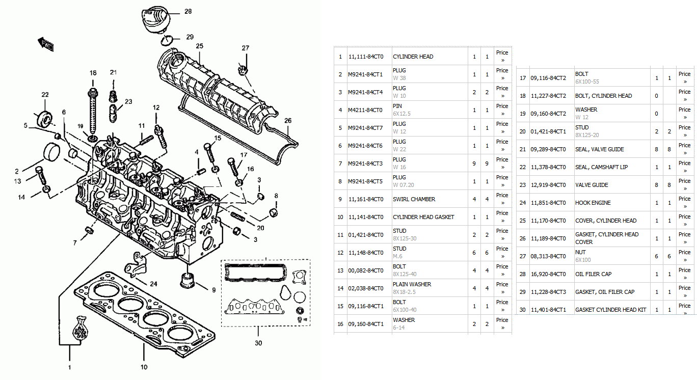

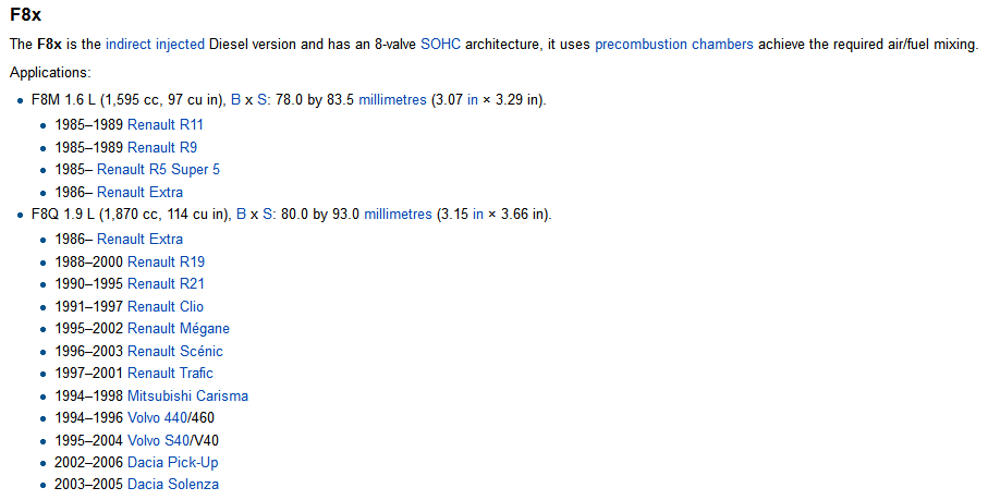

Re: anybody know what the SJ (LO4T) means?
I've been searching all over the place and kept finding you have already been there
The f8q was fitted to quite a few models
But when searching for part numbers I didn't have much success.
Some company's want your engine number to make sure the gasket set is correct so it may be worth going down that route. Somebody like this may be worth contacting
Click Here for Ebay Listing
hi Darrell,
i have been hunting around for information on my motor for over a year now.
i still cannot find out how much variation there is between various F8Q motors.
i realize they are more alike than different, but it is a bit sketch to order parts without knowing for sure they will fit.
