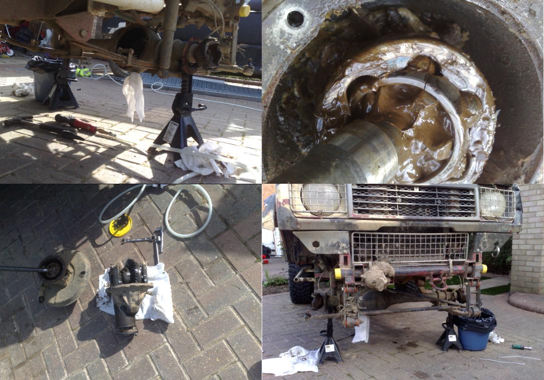

Post by urbanzook » Mon May 04, 2009 8:53 pm
sorry all but it was not my dif i just gest it was as i lost drive to the frunt wheels with a loud bang!!! an loads off clunking
an i cod spin my wheels by hand in a way that i shod not be abel to.
but it was my half shaft his the pics off the weak end work ow i wish i worked it out befor stripping the lot
