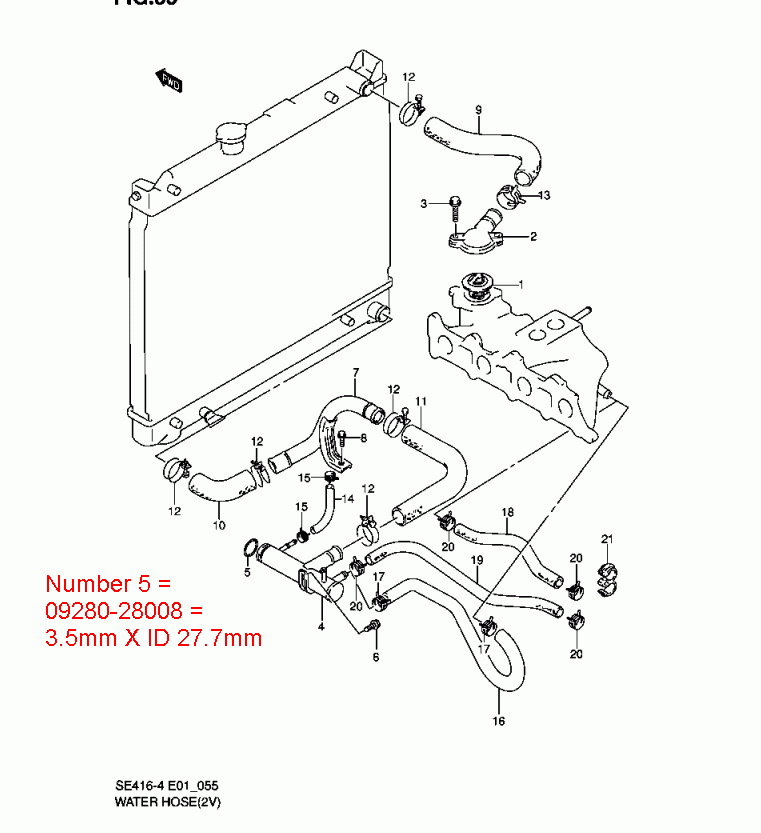

Post by Darrell » Mon Apr 08, 2013 10:37 pm
New O-ring and rtv, just to be sure :thumbup:
Re: Swapping water rails
Post by Jordi » Mon Apr 08, 2013 10:40 pm
Size o ring please?
Post by Darrell » Mon Apr 08, 2013 11:11 pm
Took a while to find that :S
number 5.jpg (80.71 KiB) Viewed 4413 times

Post by Jordi » Mon Apr 08, 2013 11:16 pm
Where do you get this stuff from?
And thank you.

Post by Darrell » Mon Apr 08, 2013 11:20 pm
Post by Darrell » Mon Apr 08, 2013 11:24 pm
O rings dimensions are normally the internal size, but it may be worth checking before/if you order any..
