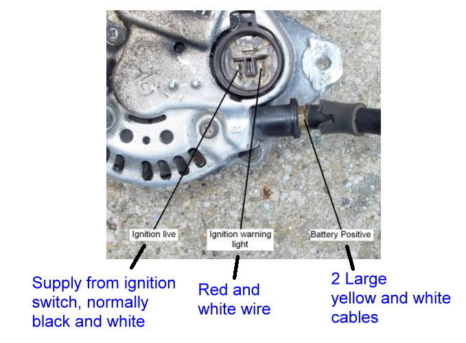

Have you got the plug for the vit alt?
It's easy to wire up the vit alt, the wiring colours are even the same.

Is the the round green plug that you need? if so I might possibly have a spare one, ill check though as my father might need it for his but if not then ill let you know!
In the mean time
Red /white tracer = L (lamp)
Black /white tracer= IG (ignition +)
White /yellow tracer to the + terminal on the starter

Post by hamer » Mon Apr 15, 2013 8:58 pm
i sure thers only one spade conector in the round plug on mine??
on the sammy thers two chunky yellow wires witch wer looped together and a skinny wire
i spaded the skinny wire and put it into the spade in the round box on alt
and the two thick wires i conected together and looped it on the bolt on back of alternater
dont no if its wrking yet aint put the testers on
do you no if iv done it right??
hope so lol
just found this
vv vv vv vv vv
Posts: 11718
Re: vitara engine conversion alternater problem :(
Post by ScottieJ » Mon Apr 15, 2013 9:46 pm
Yes some of the Alts only have the one connector, you can still use the diagram I posted as the wires will still be in the same position.
What you have done is probably correct, what colour was the small wire?

Posts: 11718
Post by ScottieJ » Mon Apr 15, 2013 9:54 pm
Probably the Lamp wire then, guess when you turn the ignition on the battery light comes on and the. Goes off once the engine is started? I seem to remember that is the only connector in the terminal on most.
It should be red and white but chances are the white bit has just gone yellow after 20years in an engine bay :lol:

Post by Darrell » Mon Apr 15, 2013 9:56 pm
Are you sure you don't have a small black/white wire hanging around ??

Post by ScottieJ » Mon Apr 15, 2013 10:01 pm
If he has the same alt as the ones I run with an externally replaceable Bosch voltage regulator then they only have the terminal for the Lamp wire ;)
My plug is still wired up with an ignition live for both types of alt though.
