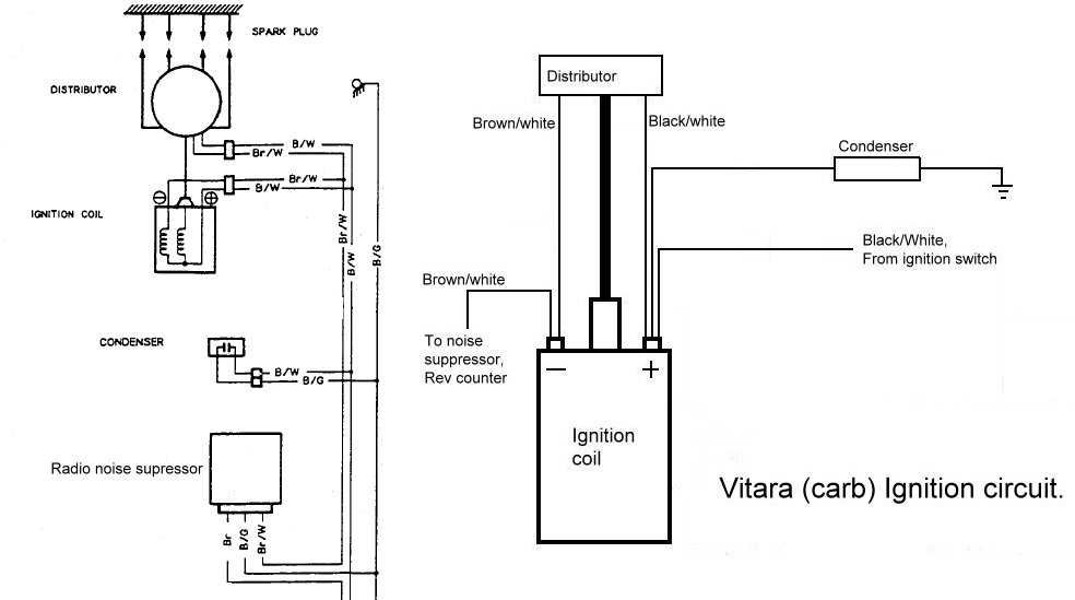

Almost finished my g16a engine conversion, however when i took the engine out of my spare sj it wasnt finished or wired in.
Everything is completly done apart from all of the following

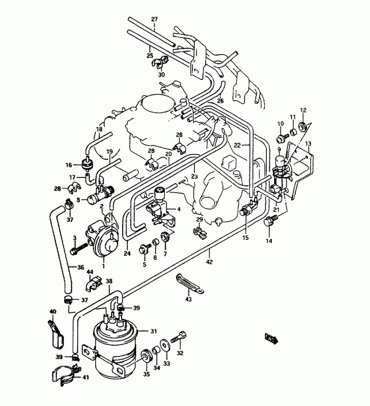

All fuel pipes not conected (including what to do with old fuel pump in tank)?

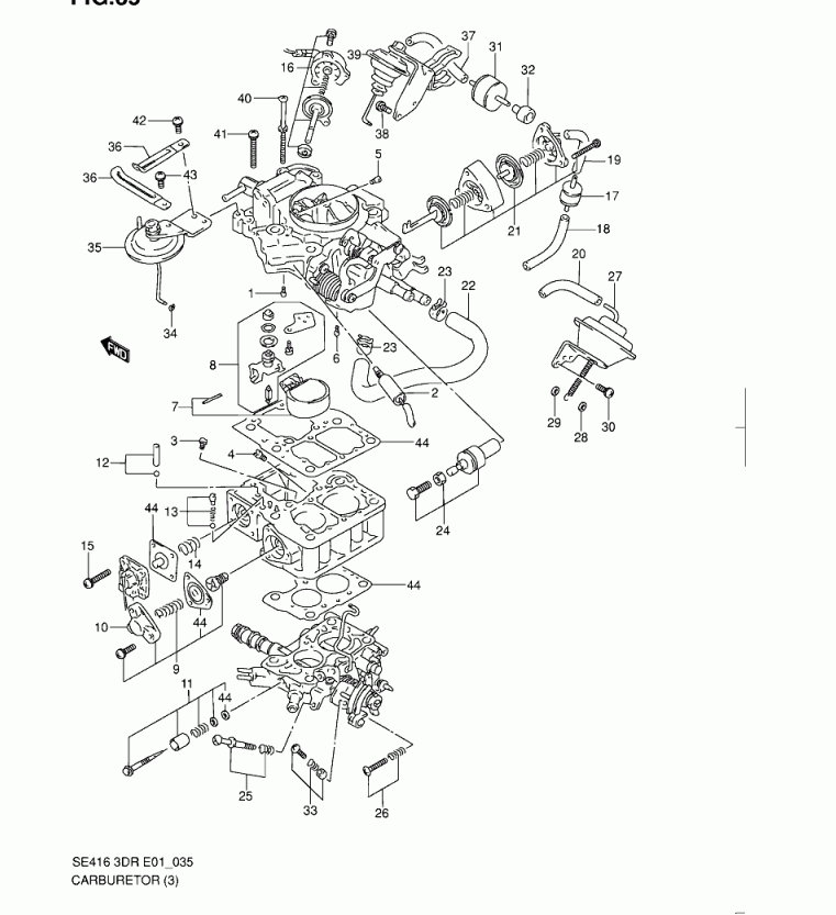

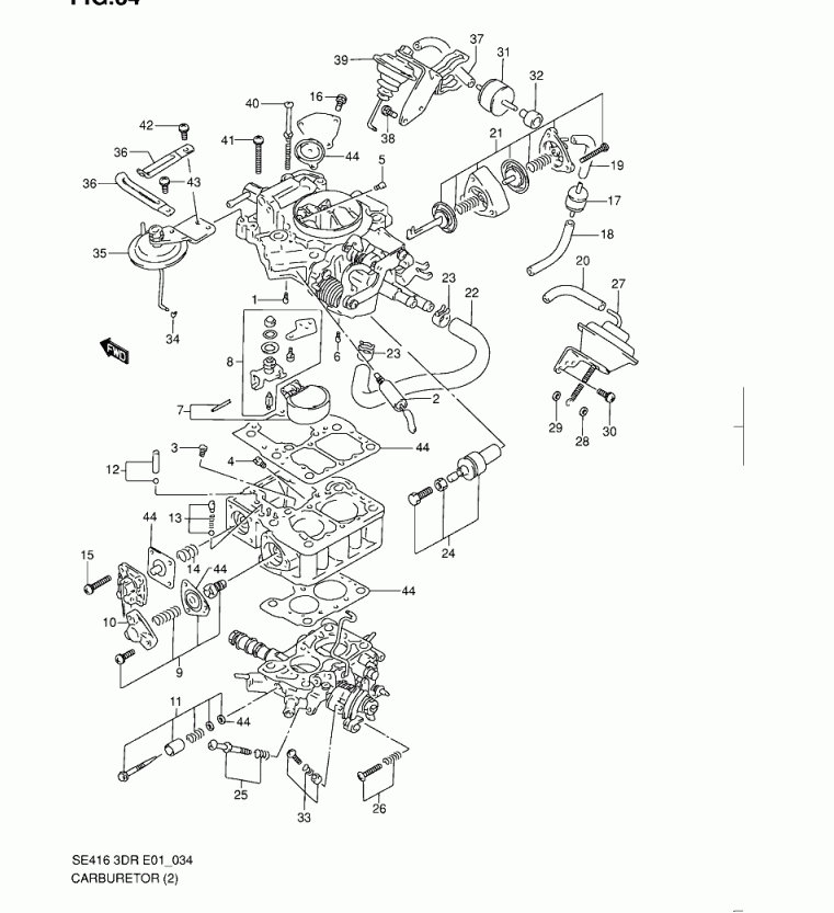

Lots of hoses and pipes coming out of standard carb (not conecting to anything)

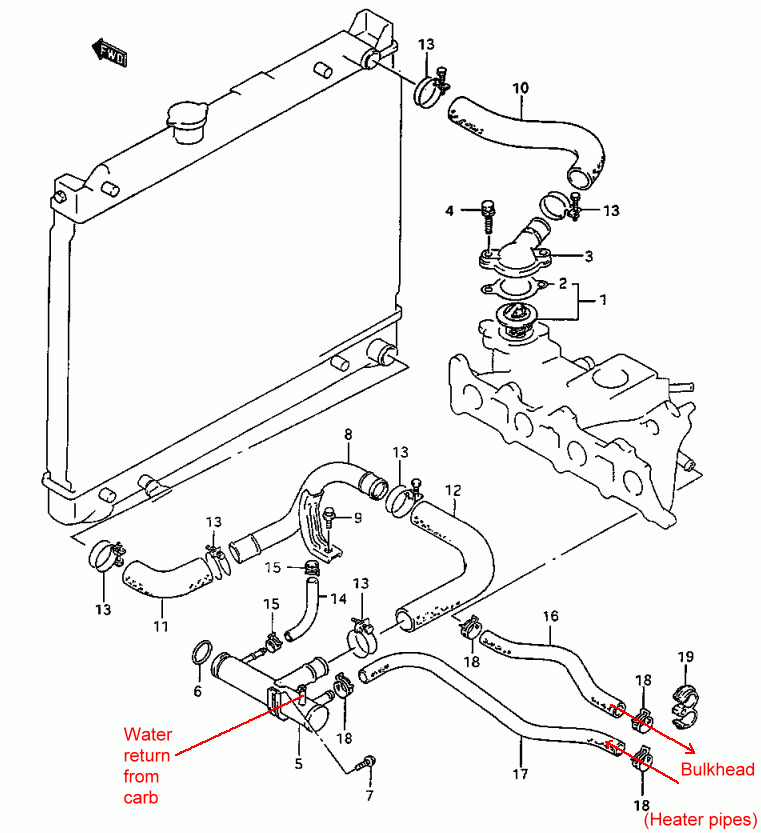

All water pipes not conected to anything (not sure where they go)
Starter and ault not wired up at all
Ignition coil and dizzy not wired in
Its basically all the plumbings and wiring isnt connected and havent got a clue how because i didnt remove the engine from the standard vitara myself :(
Can someone explain or link me where it will give me a step by step guide one how to plug this engine up? Thx, Rich

Post by Darrell » Sun Apr 14, 2013 9:41 pm
Well here's a start
Vitara 2valve hose layout.gif (41.36 KiB) Viewed 10949 times

Post by Richie » Tue Apr 16, 2013 8:54 pm
Thx, tats my water pipes sorted, anyone elsegot any help with the hoses/breathers etc from the standard carb? Thx, Rich

Any chance of a photo or two so I can try and find the correct diagram to match.
Most of the smaller pipes are for the emissions IE
I'm not even going to try and work out what all that crap is doing :evil:

Too many bloomin' diagrams....
carb 3..jpg (94.42 KiB) Viewed 10900 times
carb 2..jpg (93.31 KiB) Viewed 10900 times
carb 1..jpg (82.95 KiB) Viewed 10900 times
