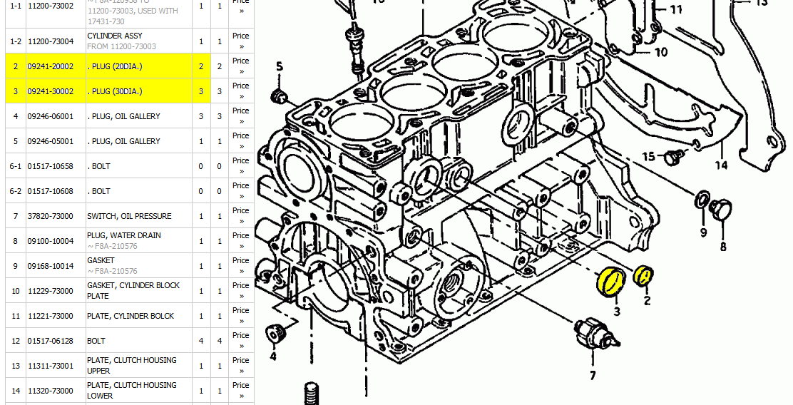

had a hour on it this pm, got the manifold off, there must be a shaped spanner for 2 of the nuts on the underside, bent up a 12mm spanner that worked.. heres a pic 20mm cores took all 3 out while i was there. curt
