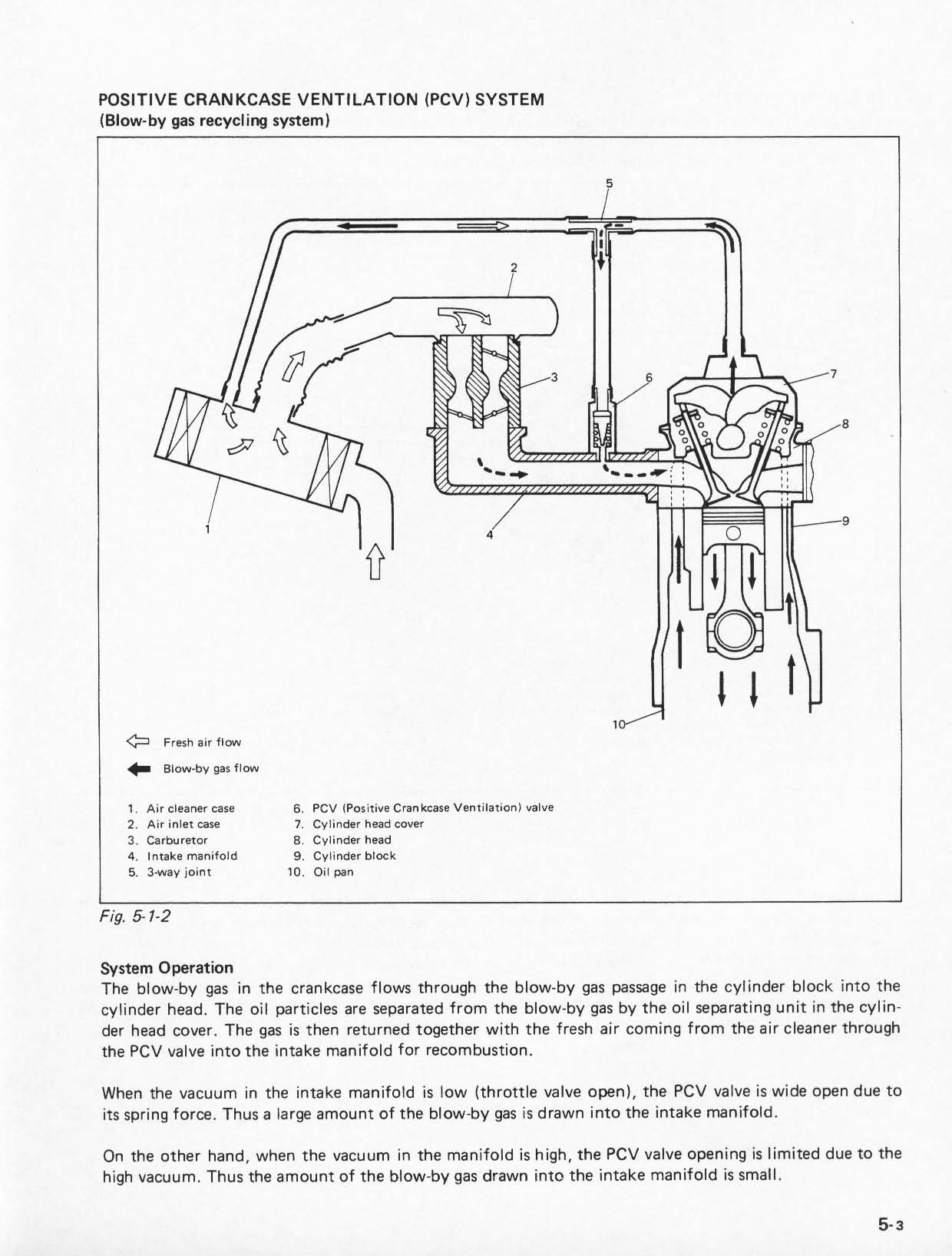

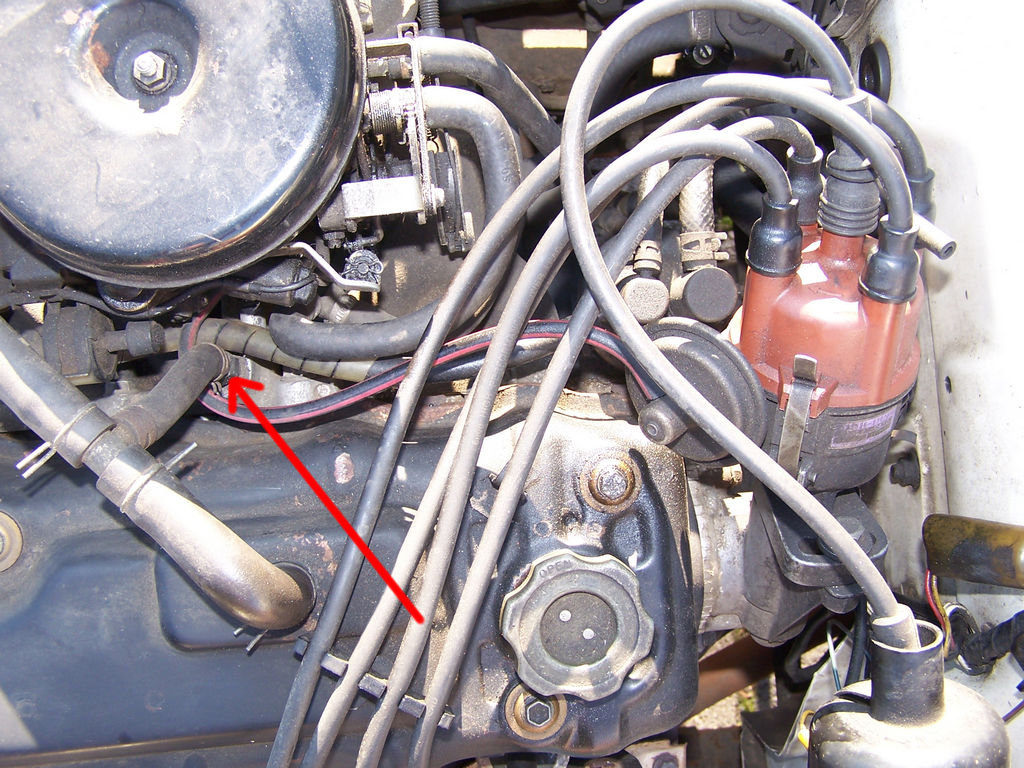

Thanks for replies what is the PCV valve ???
Yes changed valve stem seals bores looked good !
Re: Smokey Engine
Post by Darrell » Sun Jun 16, 2013 9:41 pm
This little blighter !!
