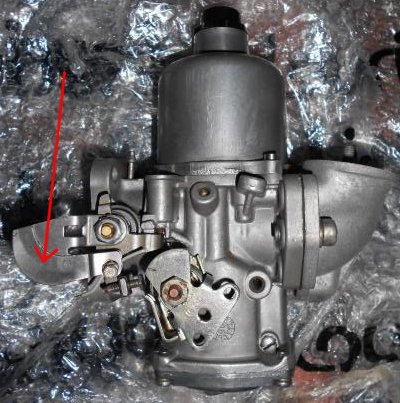

I'm using a hif44 from a pair but neither pair has any sort of fixing for an accelerator cable, had a look to see if I could bodge on something from my aisian carb but to no avail. its a hard problem to explain but i need something like on the old aisian carb where you have a bit of bent channel that the cable sits in...sorry if I'm not explaining this very well, but here is the su without the bit I could do with.

thanks kibris but its where the throttle attaches to the butterfly that I'm missing, ill Photoshop something together tonight to explain.

this is what I'm after, can anyone confirm it will go on my hif44?

This bit??
- 1345038302_428866270_1-Fotos-de--carburador-SU-HIF-44-Austin-Mini-Metro-ou-outro.jpg (52.18 KiB) Viewed 7805 times

yea that bit, didn't see your post till I posted that Darrell sorry!

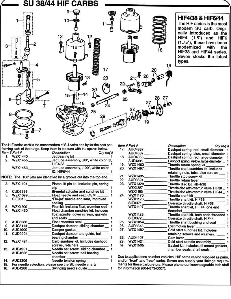

As Twiss said give them a ring. I've found this but don't know it its correct. Some SU's have a little tag with a number on for identification.
http://sucarb.co.uk/cam-lever-19084.html

thank for your help guys, still havent found the exact bit im looking for, but all the above has been brilliantly helpful!! and i will continue to search, but in the mean time i have take the throttle arm off my old aisian carb, cut off the extra stopper arm bits and just bolted it on the the current SU throttle. Bit of a bodge but seems to work, ill put up a picture later if and when i remember to take one!
