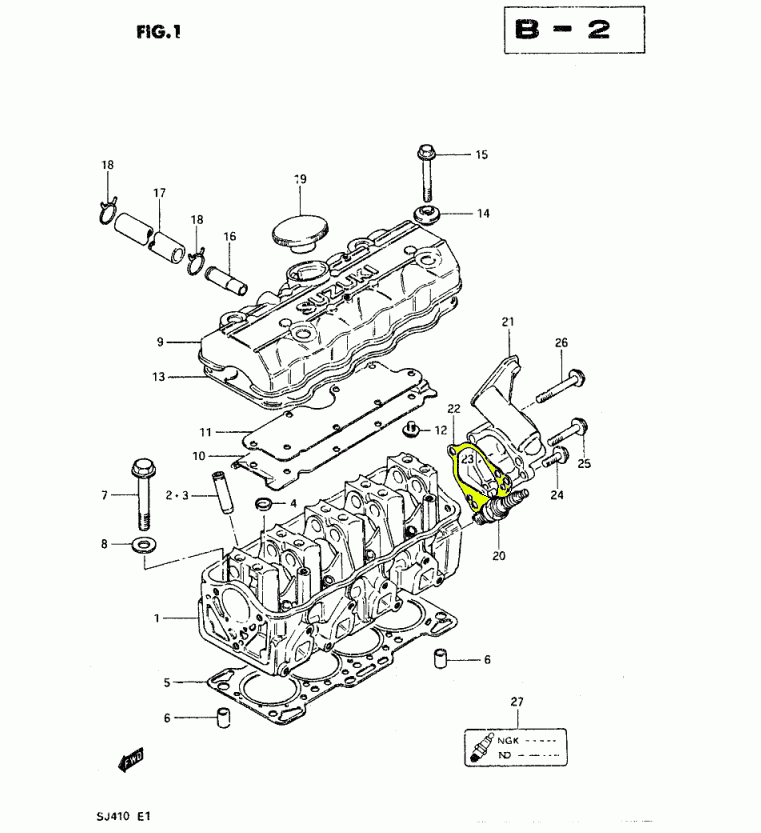

Is it possible that the gasket that joins the distributor housing to the cylinder head is leaking?

Hi, no I've cleaned the area and it's defo coming from fuel pump to distrib housing joint

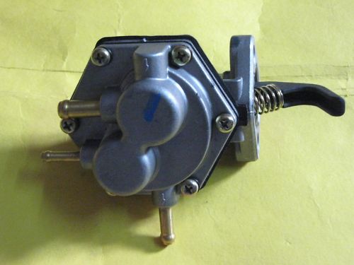

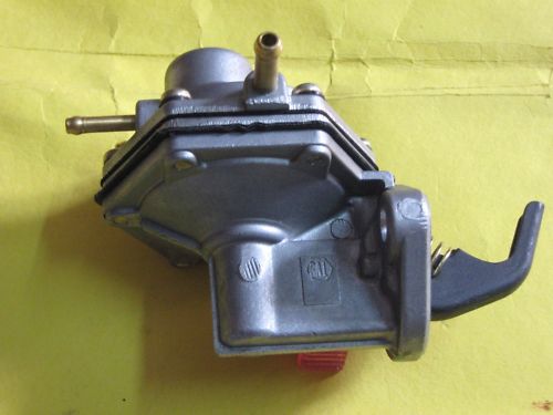

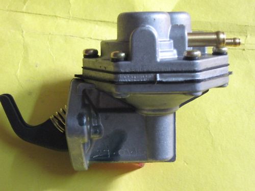

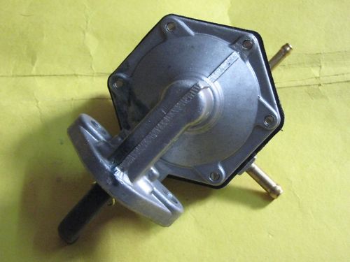

Re: Sj410 fuel pump oil leak
I don't think the 410 fuel pump has this weep hole ??
- 410 fuel pump 1.JPG (23.69 KiB) Viewed 7844 times
- 410 fuel pump 2.JPG (23.85 KiB) Viewed 7844 times
- 410 fuel pump 3.JPG (23.89 KiB) Viewed 7844 times
- 410 fuel pump 4.JPG (24.86 KiB) Viewed 7844 times
