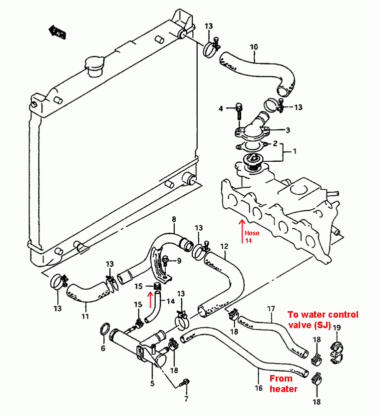

Just got my engine sittin in place ready for welding and was gunna start connecting things up and the throttle cable is short do i need a vit one or a sj413 one ? Also if u are lookin at the pipes from the front am i right that the the pipe on the right goes on the hole next to the bottom rad hose hole and theres a nother pipe that further up that goes to one on the back of the manifold ? Thankss

No really sure I understand the question on hoses :oops:
But here's the vit layout, just there is a water control valve on the SJ.
1600 vit.gif (50.97 KiB) Viewed 6432 times

thanks Darrell big help , aye mite have to get one mine is defo to short will mine be the same setup as carb or different being a spi thanks
