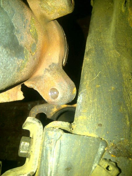

Post by twiss » Wed Oct 02, 2013 10:47 am
One type of manifold is for a single down pipe and the other is for a twin down pipe.

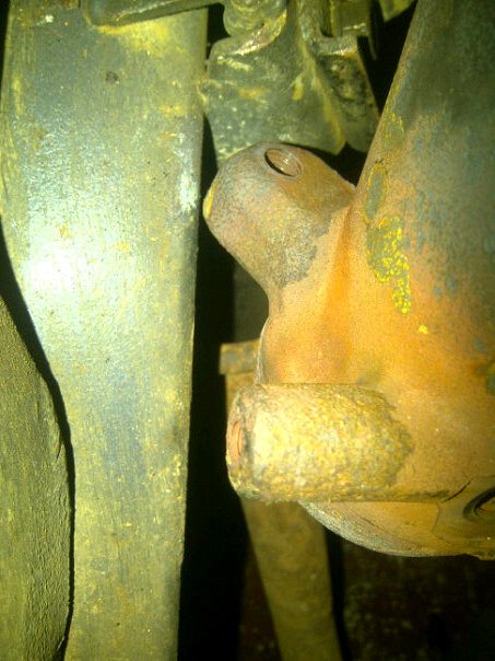

Ive got a single exit manifold and it only just fits so I don't know if the twin pipe one will fit easily!
Without tilting the engine to one side slightly (I like my gearstick straight haha) the downpipe flange only just clears the chassis rail (with some mild trimming)
I can't find a pic of both manifolds, but these are the downpipes for each

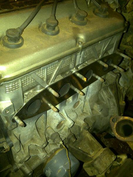

You can easily tell if its for a 16v head as the bolt holes in the manifold are lined up vertically instead of staggered like on the 8v head and manifolds

Lined up mounting studs:
What the manifold looks like:
Flange clearance:
