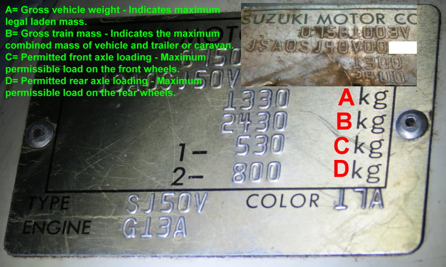

Just been looking at the codes. and would you say this is 'fantasy black?'
its a 1991 SJ413. looks black to me, but what black, was going to order a bit of paint to touch it up with.

The vin plate should show it's original colour.
If it shows 07B (fantasy black) I should just buy some of that.
To be honest, given the age of SJ's I doubt if it will match 100 percent.
Unless it had a respray.
