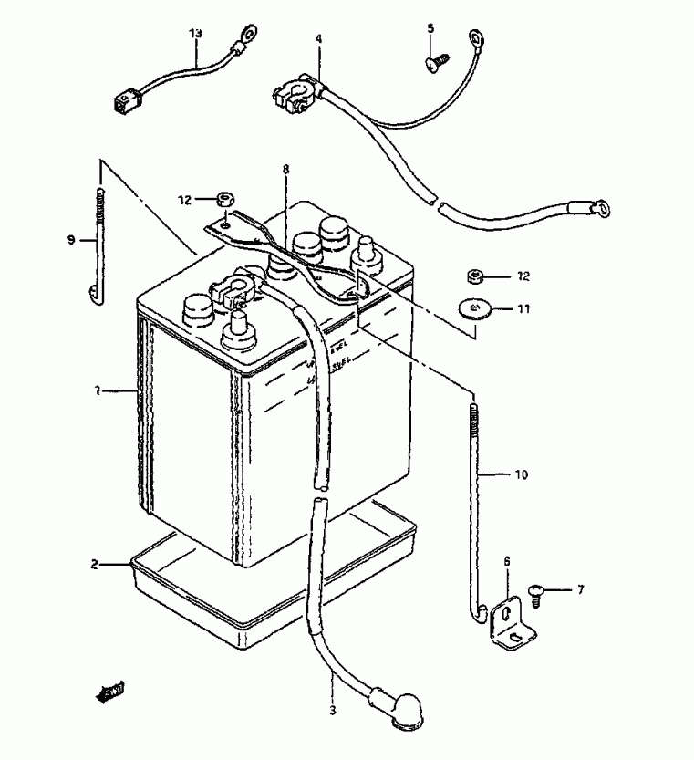

Battery fixing....anyone know how the battery should be fixed down....mine isn't and it failed the mot because of it ! :pissed:

Here is a pic of the SJ fixings.
A kit from halfrauds would do the job, but one side may need shortening and the end bending back ?
http://www.halfords.com/motoring/bulbs- ... tery-clamp
A bit of flat bar with a couple of holes and some threaded rod from the DIY shop would do it if the filler plugs are flush with the top.
