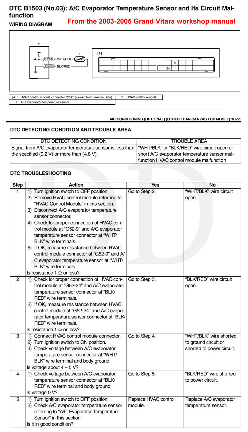

The B1503 is a fault code from the air conditioning.

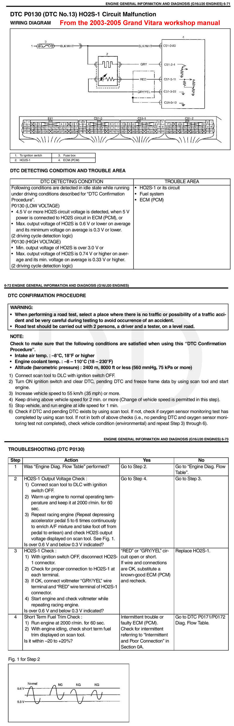

The code 0130 I don't recognise, however if it had a P in front of it, it would be O2 sensor problem.
This is more likely to cause running problems.

Few extracts ..........
GV Evaporator Temperature Sensor.jpg (228.89 KiB) Viewed 6243 times
GV HO2s-1 .jpg (391.41 KiB) Viewed 6243 times

changed the lambda sensor and it looks like a 5 year old changed the battery with new clamps (that didnt fit) dont think his fisher price tools could tighten it up haha
problem seems to be sorted thanks for your help
