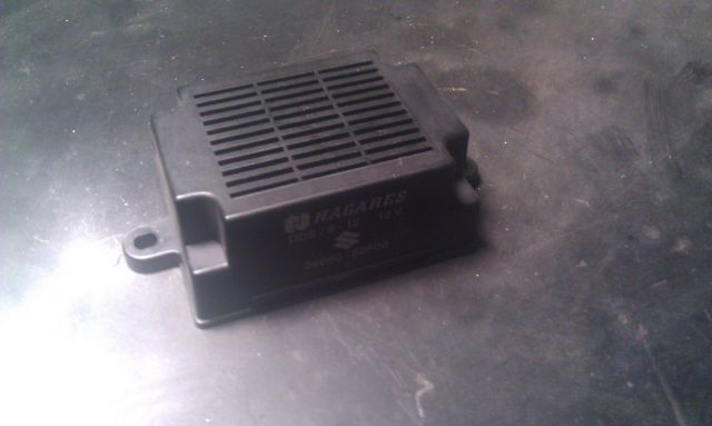

Some vitara's had a dip-dim unit
- vit dip dim 1.jpg (25.47 KiB) Viewed 10427 times
Re: headlight module
thanks darrell but mines off a 92 vitara jlx, the module is metal with fins topside to dissipate the heat, inside is a pcb (am descibing cos am too rubbish to learn how to post a pic!)
i guess the one in your photo is the latest version which am sure would do, so if anyone out there has one spare in working order then i would be glad to purchase the same k

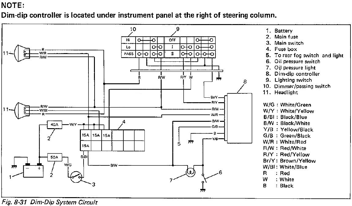

Looking at the wiring (if correct for yours) for the dip dim unit it looks unlikely to make either side fail.
- vit dip dim.jpg (144.33 KiB) Viewed 10398 times
thanks darrell, am pursuing the bypass option and have forwarded your wiring diagram to my auto electrician

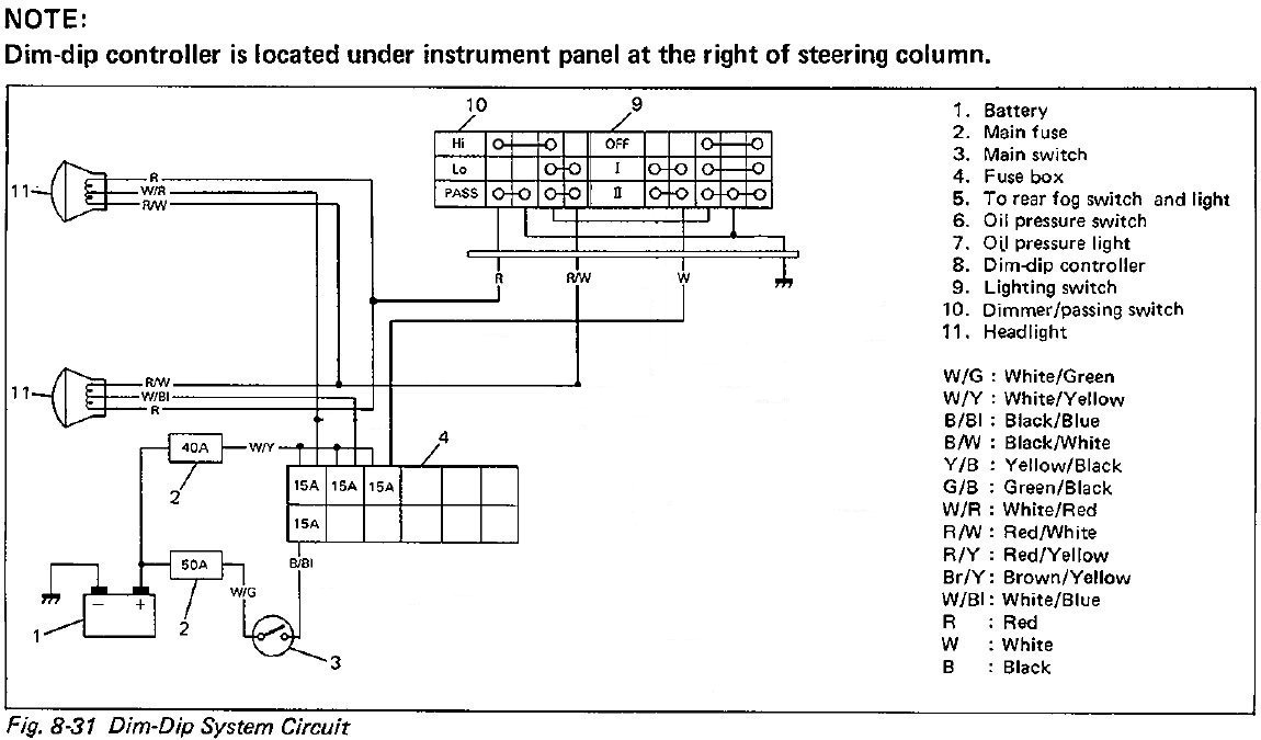

I've just been through the diagram and like Scottie says it's like the SJ one.
This can normally just be unplugged and left alone.
The common fault is when the dip-dim unit fails the lights won't turn off.
I still don't think this is why you have a headlight out.
When checking for voltage on this circuit, unplug both headlights as the positive current will go through the bulb elements and give you 12v positive on most of the circuit.
I've just scrubbed the dip-dim from the diagram to clarify things
