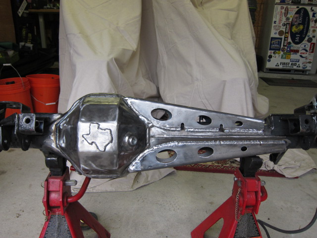

Don't really have a clue about the landy axles but something like this
- IMG_1834.JPG (108.57 KiB) Viewed 10645 times

@twiss,so am i right in assuming that you strengthen the Suzuki axles because the are prone to bending when using in extreme off roading ??? you dont get the problem for normal driving its just extreme off roading right.

Lots of people do but I haven't on my 31s. ScottieJ's axles are what I would do if I was going up to 33s.
So far I've only managed to bend an axle once after a rather large jump... but that was on 195s
