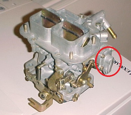

I cant remember if its the right carb but in red circled area is a diaphragm, which if split will cause the revs to rise and fall.
- WeberDGV.jpg (61.36 KiB) Viewed 9417 times
Re: New problem, new thread.
Thanks for the suggestion Robbie, just took diaphragm out to check it and it looks OK.
