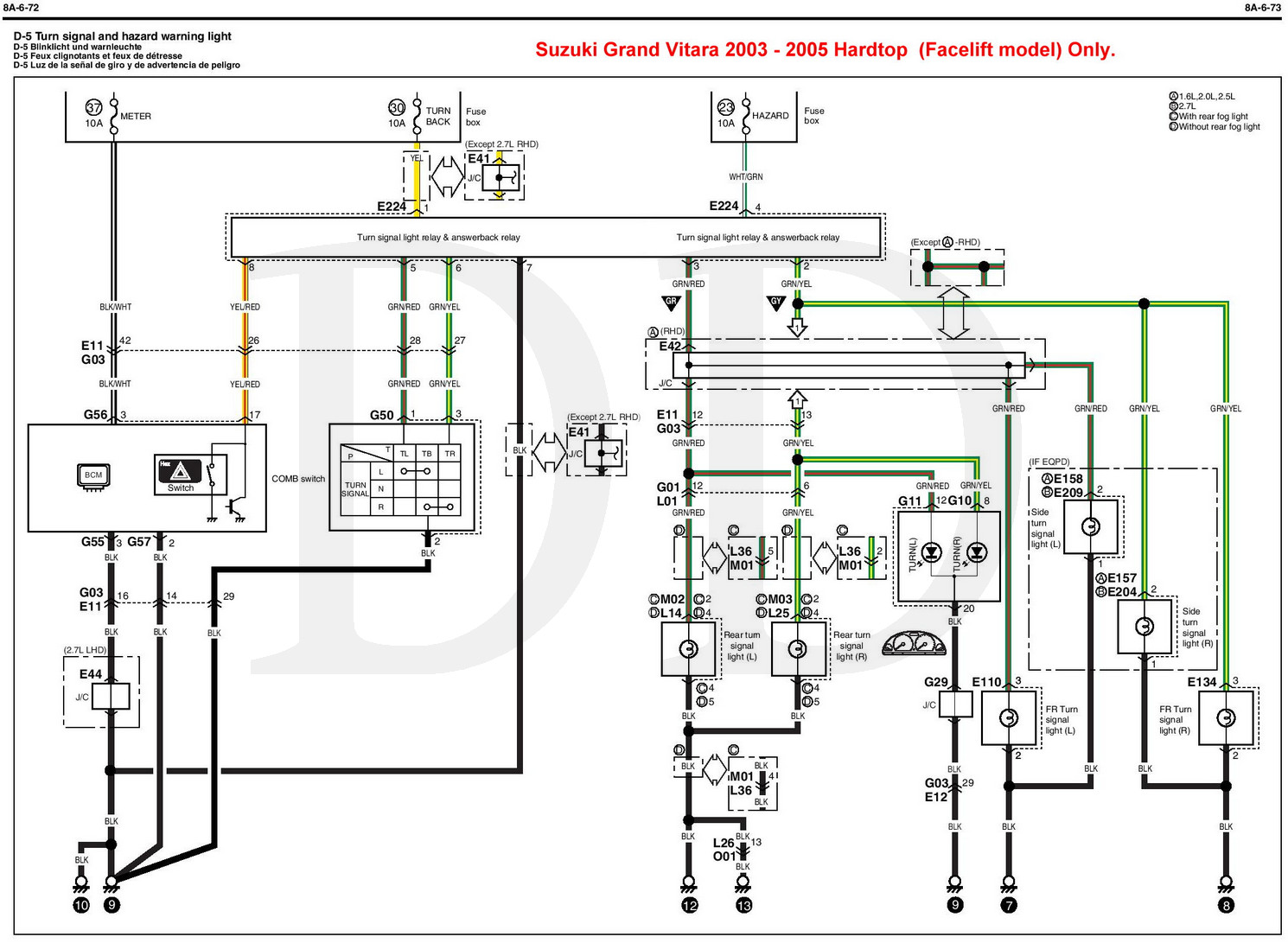

Post by Darrell » Wed Dec 24, 2014 5:24 pm
Yep.........
Grand Vitara 2003-2005 hardtop indicator circuit.jpg (305.73 KiB) Viewed 4290 times

Post by MikeMaxo » Sat Jan 30, 2016 7:08 pm
Darrell wrote:Yep.........
Fitted a Hawk kit, all ok other than the lights flashing...
Connected the kit output to the gr/red and gr/yellow, no joy other than blowing the in line fuse from the Hawk. Tried the yellow /red for the hazards still no joy.
The instructions say - Positive hazard light output, connect to the circuit that shows + 12v or only when the hazards are on.
2003 newer dash model.
Old thread but any ideas what I'm doing wrong?
Cheers.

Post by MikeMaxo » Sun Jan 31, 2016 10:57 am
Just for info now sorted, was the colours I mentioned but wires from a different block to that I first tried, block closest to bulk head worked.
