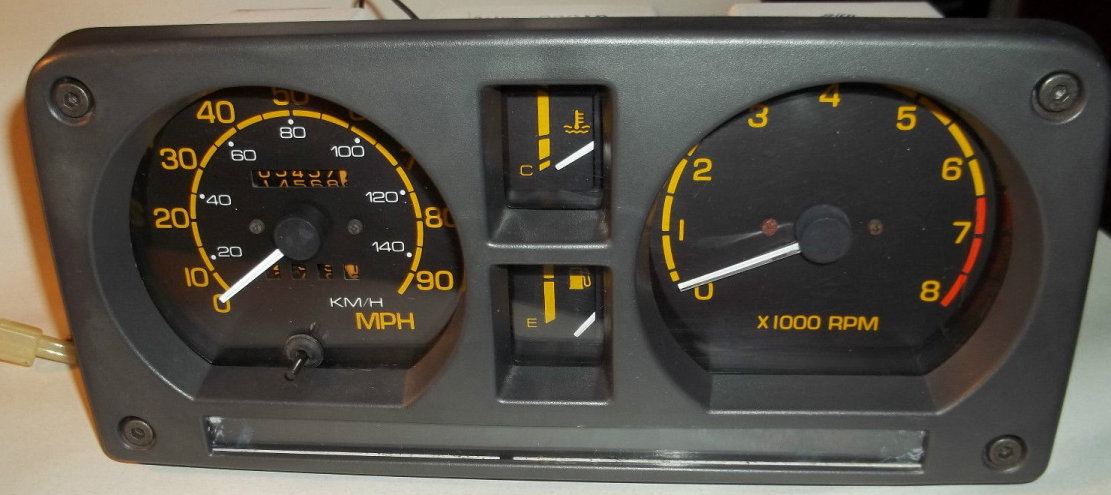

This is my spare out of a Spanish 91 I think

ScottieJ wrote:Image
Same as the one in my Spanish 91 Sammie

Post by twiss » Fri Oct 07, 2016 12:19 am
Looks like mine too apart from i've got a green circuit "board"
