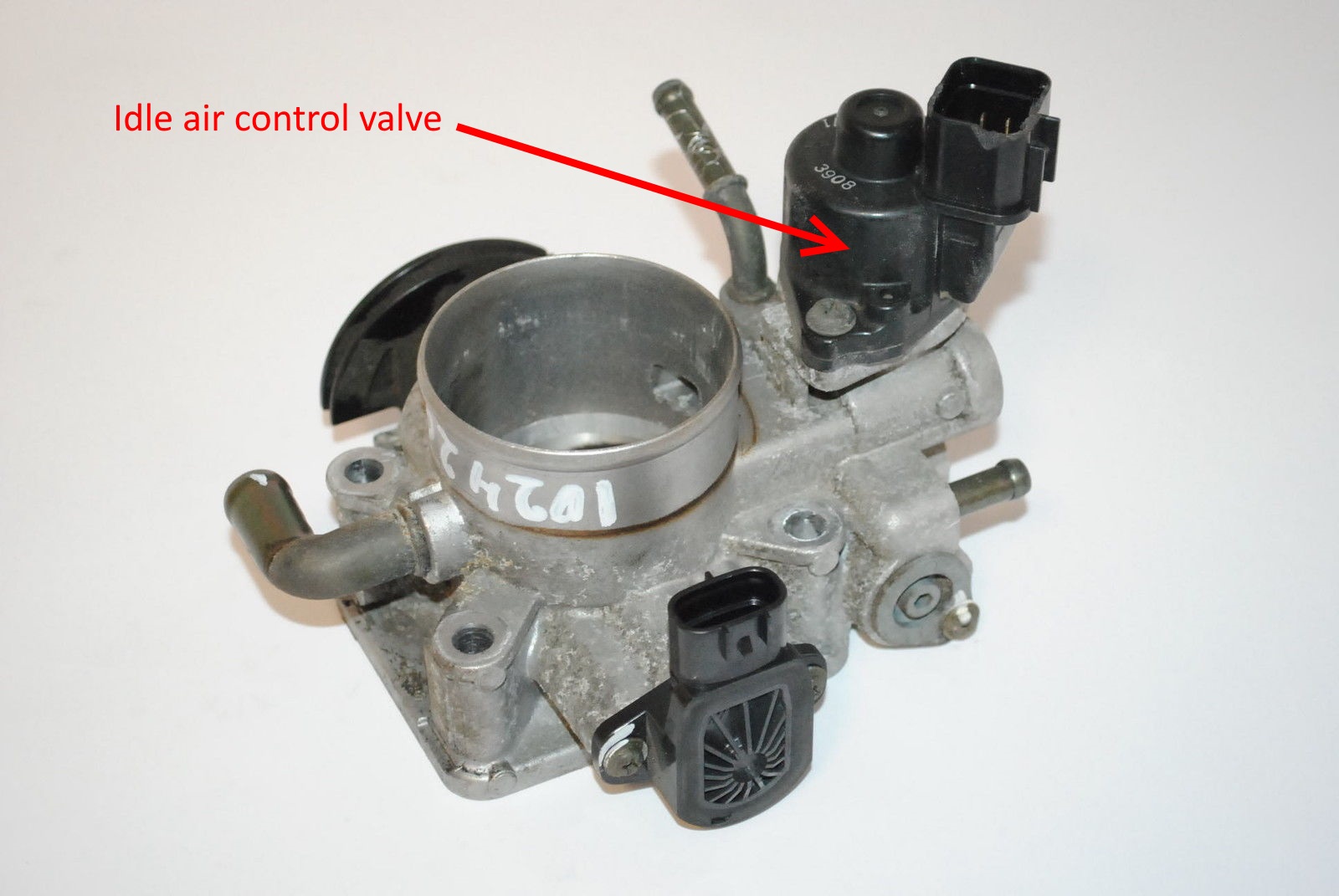

Is it possible the idle air control valve is sticking and you hear this shut when you tap the TPS.

thanks for the idle air valve suggestion but its not it.
i ve had a go at it three times today. when i tap the air valve nothing happens. only when i tap the sensor and i literally mean tap. like a tap when you knock on the door kind of tap.
