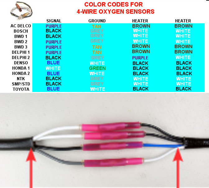

hi, just need to know how to wire up a new universal sensor.
my suzuki is a 1993 jlx 1.6i just fail mot on sensor right off the scale.
its a 4 wire job any help gladly received thanks :thumbup:
Re: lambda sensor
Post by Darrell » Thu Apr 06, 2017 8:33 pm
Welcome to the forum. Could you post up what colour wires you have from the loom to the sensor connector and from the connector to the sensor. Also what universal sensor do you have to fit. Can you also confirm this is the 16V multipoint injection engine. Pics if easier :thumbup:

Post by samuria » Thu Apr 06, 2017 9:02 pm
this is the sensor i bought..http://www.ebay.co.uk/itm/291706163399? ... EBIDX%3AIT
the wires on the loom are black/ green tracer
black/blue tracer
yellow
white
the wires on the sensor are 2 black 1 blue 1 white
thanks :thumbup:
Re: lambda sensor
Post by Darrell » Thu Apr 06, 2017 9:36 pm
Well I checked multiple charts and they matched with this..

Post by samuria » Sat Apr 08, 2017 6:04 pm
fitted the new sensor all seems ok,,,
will have to wait until its mot on monday :roll:
Re: lambda sensor
Post by Darrell » Sat Apr 08, 2017 10:06 pm
samuria wrote:fitted the new sensor all seems ok,,,
Fingers crossed :thumbup:
samuria
Posts: 10
Joined: Thu Apr 06, 2017 3:38 pm
Re: lambda sensor
Post by samuria » Mon Apr 10, 2017 5:52 pm
well it passed the mot ... only just :roll:
