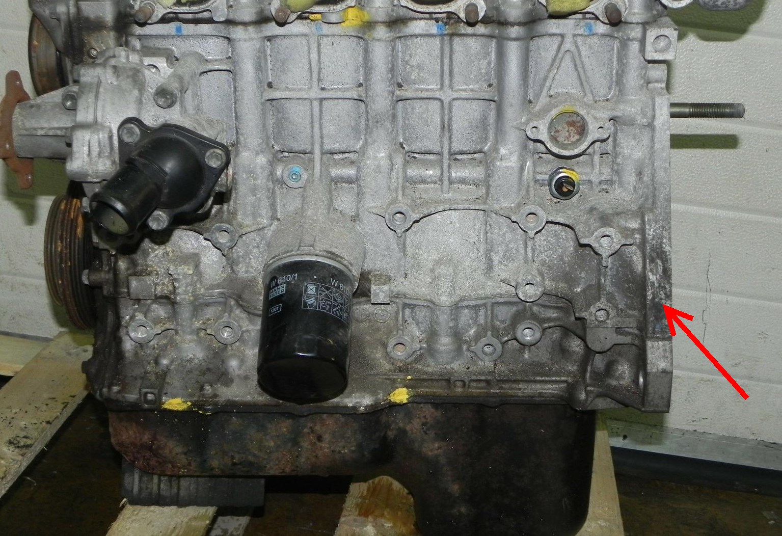

I've attached an image of the engine

Post by Darrell » Sun Jul 16, 2017 6:48 pm
Yep, that's a J20A

Post by ScottieJ » Sun Jul 16, 2017 7:10 pm
^^ what he said! 100% a j20a so there's probably just been a mix up when it was registered.

Post by Darrell » Sun Jul 16, 2017 9:28 pm
It should say J20A here along with the engine number.

Post by Matsuzuki » Mon Jul 17, 2017 7:26 pm
Cheers for the photo of the engine number location, I checked it today and it does state that it's a j20 and the number matches the one on the v5 so all is well!
