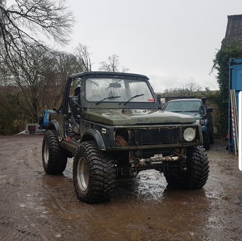

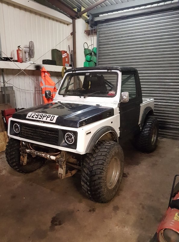

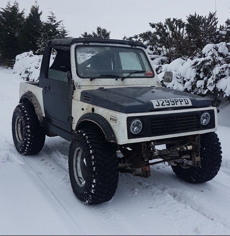

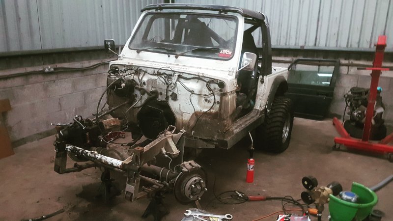

Hey again not been here in a while. A bunch has changed had a tin top for abit but I've rebuilt and have started again on my samurai.
Now running 33x13.50x15 mudzillas, 2" inch springs all round with standard shackles, box section will, rock lobster, welded rear diff, 1.6 8v injection, roll cage and currently in the middle of my front virtual lift.
Some quick pictures I'll dig out the photos from the cage build and get another post up soon.
Looking abit rough
Looking abit rough
Air back in the tyres
1.6 8v injection going in
Out in time for the snow
In bits again.
In bits again.

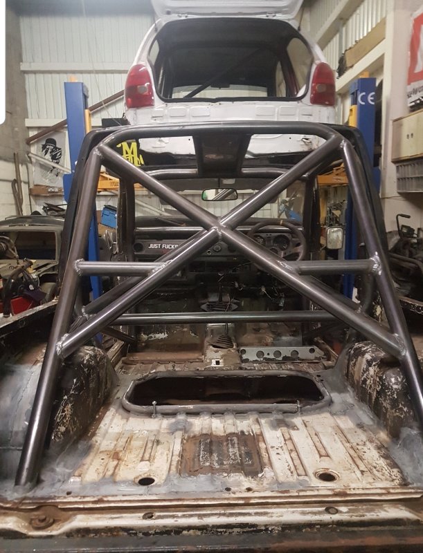

Found the cage pictures. It's welded to body and chassis so i won't be able to get the body off but I'm okay with that 😂
This was all done in January 2018.
At the same time as I was switching to 8v injection.

Post by Rabid Rhino » Thu Oct 25, 2018 5:46 pm
Who did the cage ?
It looks superb. The welding looks spectacular. Work of art.
Posts: 370
Re: sj413 samurai pickup
Post by Rankine » Thu Oct 25, 2018 10:54 pm
Was My friend Alan he's a welder fabricator that builds drift cars. Used to help hm in his garage before.i got into offroading.

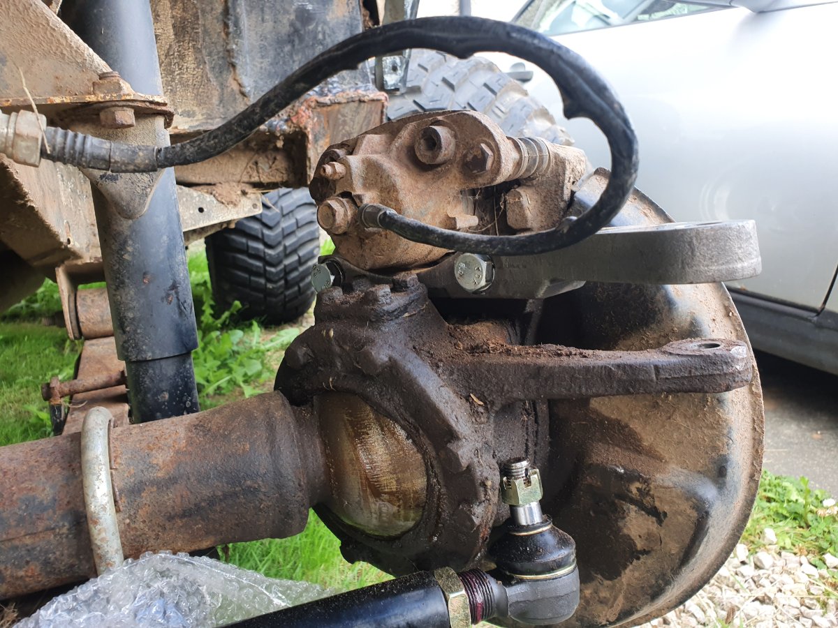

Got some good post today. New high steer set up. Hopefully get a start at it tomorrow.

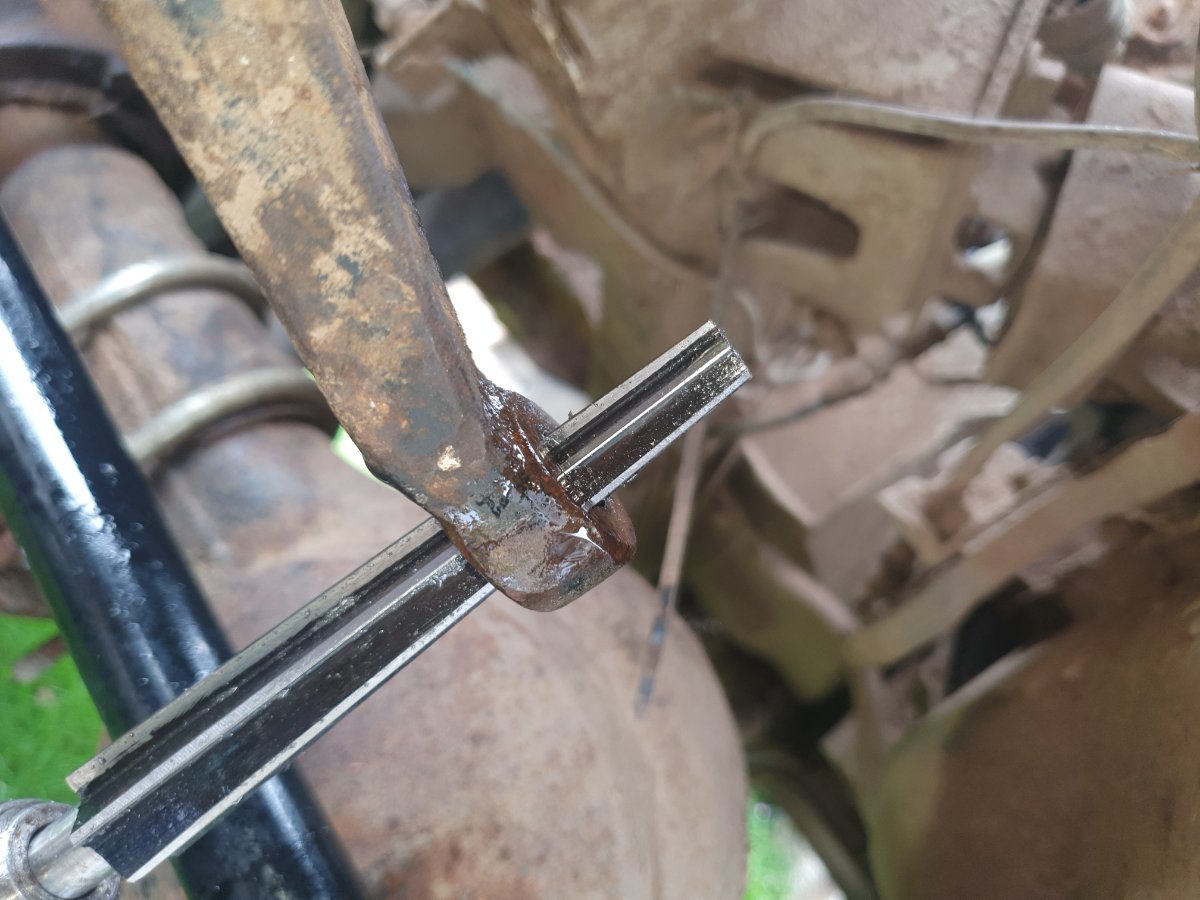

Got the steering fitted today was pretty straight forward took some photos while i was at it to.
I've noticed the steering bar is now pointing up the way.
But what a improvement in the handling theres no more death wobble 😂 hopefully getting the tracking done before clog on sunday.

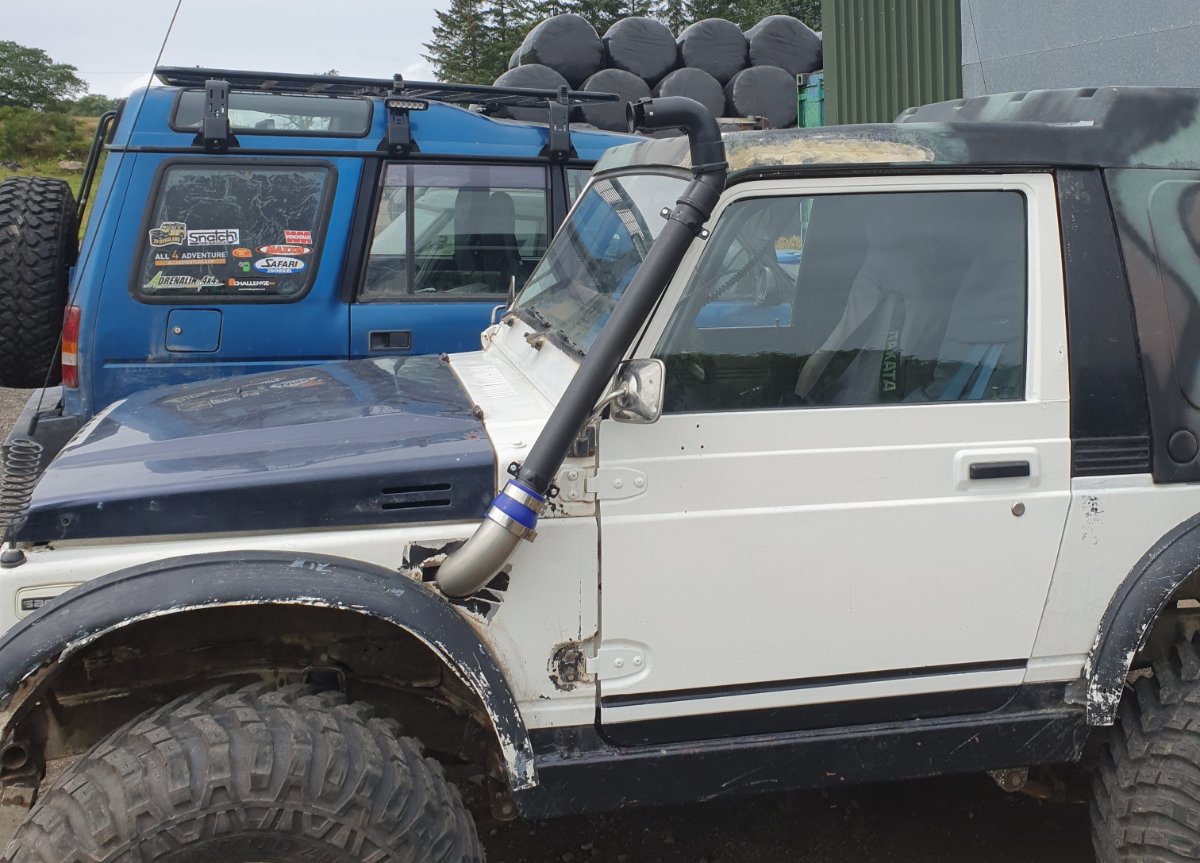

Also decided I better get the snorkle sorted for the weekend.
Made it from a boiler plume kit and some intercooler hoses and clamps.
