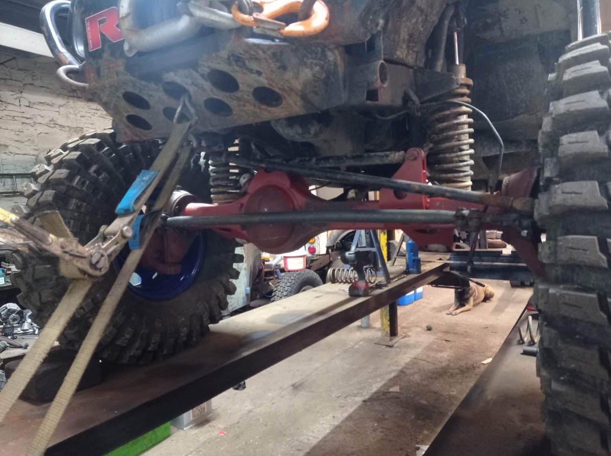

Props now both on, wound the links up in the front axle to make prop angle better, useless landrover props !
The other guys don't stand a chance at your next event

This is front axle re drilled now to sort out the king pin angle.
Got a bit more setup to do but we nearly there
Discs are machines and calliper brackets made test fitted one and they clear.

Looking good man rims look close to the portals.
- mike harris
- SCUK is my life
- Posts: 1828
- Location: hascombe Surrey
Very close, il post a video
