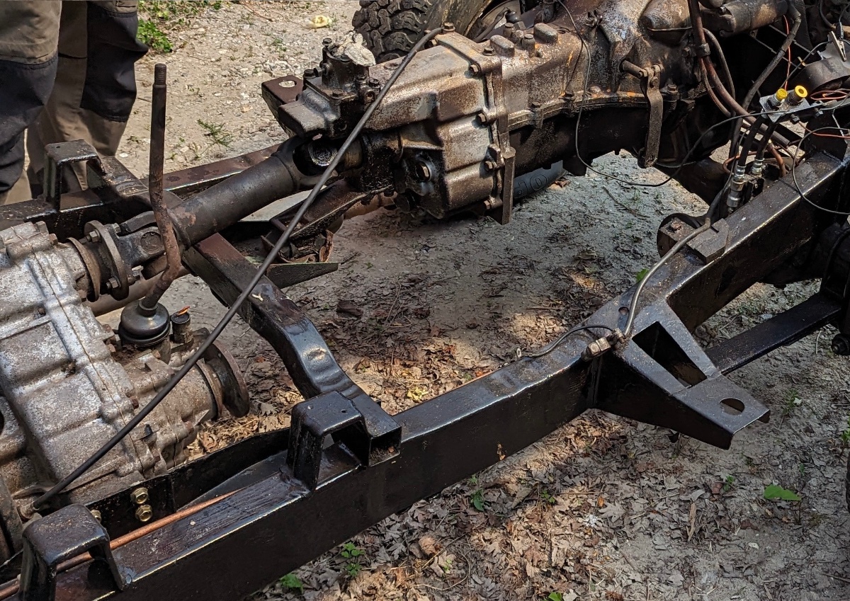

I am searching for a post i believe i saw from you, but i cant find. It was about how to tell the difference between type 1 and 2. Mine has steel dash, disc brakes in front and 4wd light in dash. I believe i read that was type 2? Is it so that the 413 gearbox will fit, so i can swap to g16a?

If your gearbox crossmember is this style then yes a 1.3 gearbox will bolt straight in and the gear lever will be in the correct place.
Try to get yourself some 1.3 engine mounts cut off a 413/samurai chassis as it will make the job loads easier as well.
The ZukParts adapter kit from NZ is the best one to use.

Thanks for the advice this far. But i am wondering because of ease of access for myself, what about vitara engine mounts? I already have those. Or are the 413 ones preferable

You need the 1.3 mounts for the engine to sit in the correct position. Have a read of this thread viewtopic.php?t=9512
