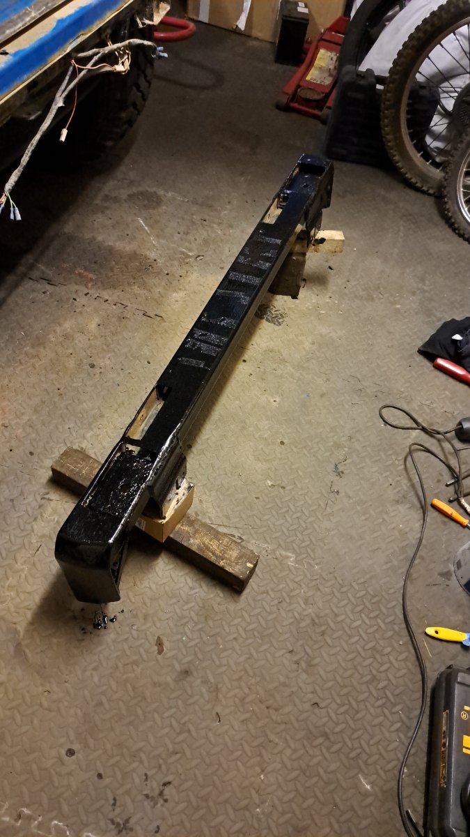

Whilst it's still in garage iv pulled rear bumper off to give it a clean up. Getting a right overhaul is old girl, suppose it's only fair, been on road 4 years now!

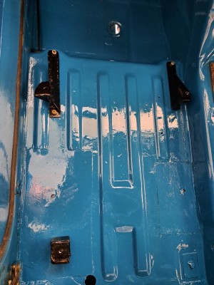

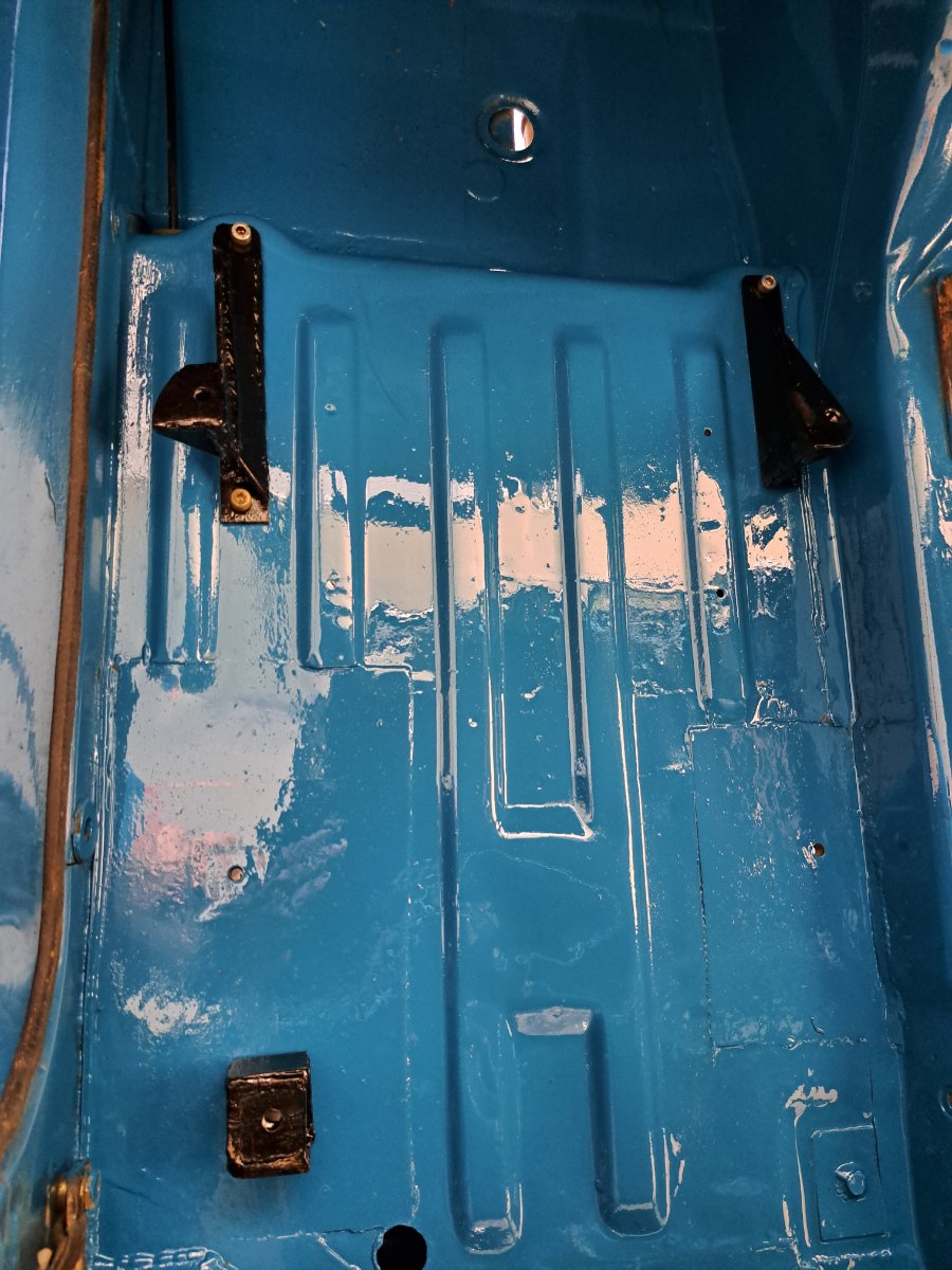

Post by d_r_1989 » Sat May 10, 2025 9:05 pm
Got the seat mounts painted
Posts: 365
Re: Coiled turqoise samurai 16v
Post by Rankine » Sun May 11, 2025 8:27 am
Look a good fit in there man.

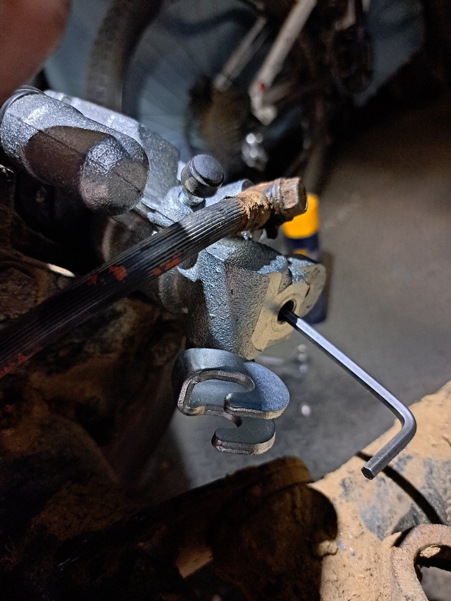

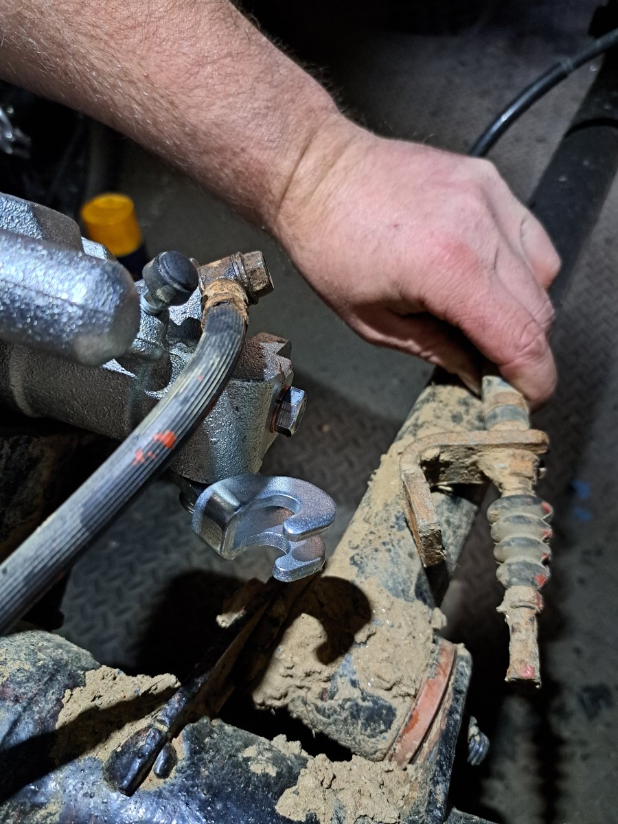

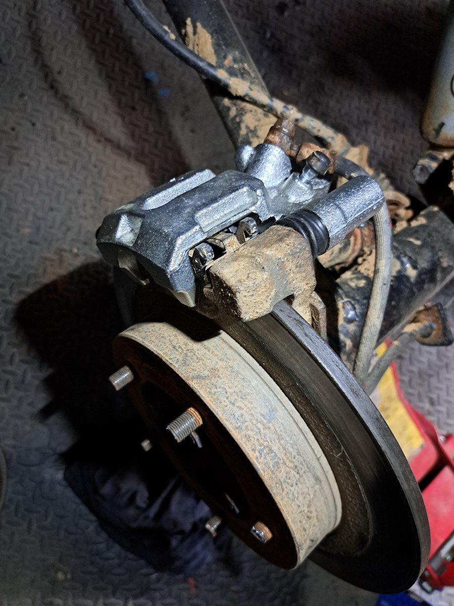

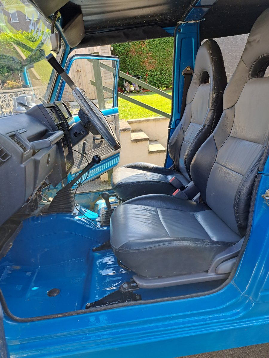

Post by d_r_1989 » Fri May 16, 2025 1:21 pm
Ye they're such an upgrade to them original seats!
So it's passed it's mot and developed a leak on the rear caliper on the way home, new caliper for £38 and problem sorted.
A couple pics of the caliper setup for anyone that's interested, mx5 calipers are really easy to work with.
