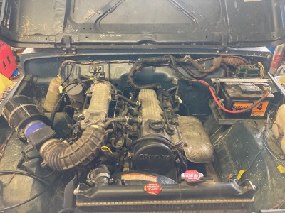

Well that turned into a nightmare.
Got the loom all buttoned up, went to start it and the immobiliser wouldn’t de activate :argh:
Spoke to the legend that is Rhinoman about re-syncing the ECU and ICU however because the donor was out of a later GV he wasn’t sure he would have the codes needed to re-sync them. The other problem is that they are wired differently to the earlier GV G16b because they use a different ICU :S
So I decided to swap the complete engine harness out of Blue as it has the earlier loom.
A very long day of re doing the loom and she fired up :rockin:
Time to throw a new timing bet on, get the cooling system plumbed, alt belt on, PS plumbed up and see if the EML turns off :popcorn:
Seems mad that I’m gonna do all this work and put her up for sale but needs must.

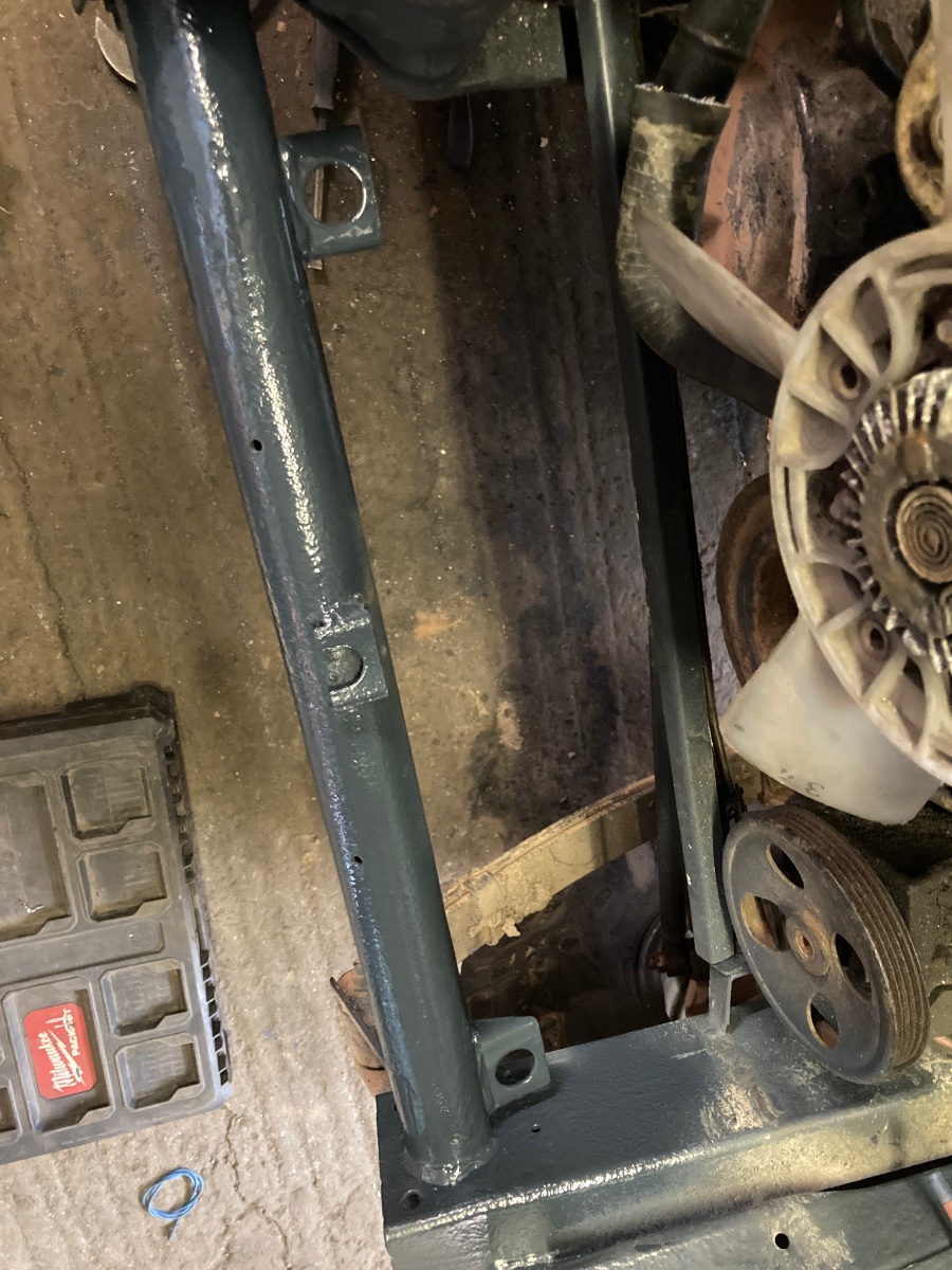

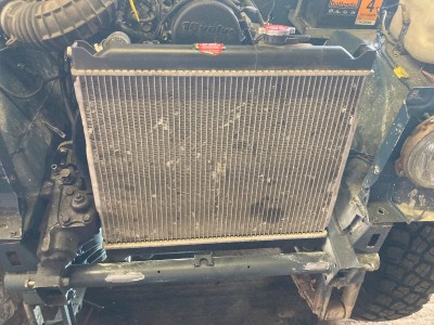

Almost there with now, few belts to order and a bit of tidying up and I can run it up and get the dash refitted
I decided to reposition the rad to run the 1.6 viscous fan instead of an electric fan.
Need to modify the PS pipes again now the rad has moved 😅
This swap has definitely turned into more of a challenge than it should have been but I’ve learnt a few things on the way.
